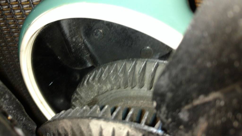

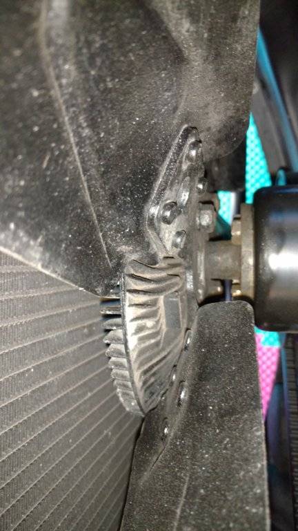

i do have a shroud and the fan does spin some then stops. the fan, shroud and clutch are all original. Are we sure on a thermo clutch? The picture in the 68 manual shows a torque control fan drive the look more like it. The one picture is with a mirror in front of it. Or would the thermal control drive give me more cooling a idle and low speeds?
IMG_20170924_113128851.jpg IMG_20170924_113239439.jpg IMG_20170924_113930145.jpg

The hoses are not collapsing and also are new. When I fill it up to within 1/2" of the top it will blow off enough to expose the top of the tubes. The original radiator was recently re-cored and a extra row of tubes were added. The timing is on and dwell is correct. As per the first picture I have enough room to put a mirror between the clutch and radiator. it also has the original shroud. I bought this car new. Just did a complete restoration but did not take apart the engine as it only has 52,000 miles on it.
As others have said, you probably should be using a 16psi cap and replace the 195 thermostat with a 180. Also on the thermo / non thermo clutch issue. I have read in a couple different write-ups that the Thermo unit is better than the non thermo in that it controls the temp better and lasts longer while supposedly giving you better gas mileage. I do know they cost more. For my money, I would use the thermo unit that the A/C cars have and go with a 180 degree thermostat & a 16psi cap to start with. The top of your tubes should not be exposed. Also, your fan looks awfully close to the radiator in your picture. Maybe with the extra core, you need a shorter shaft.

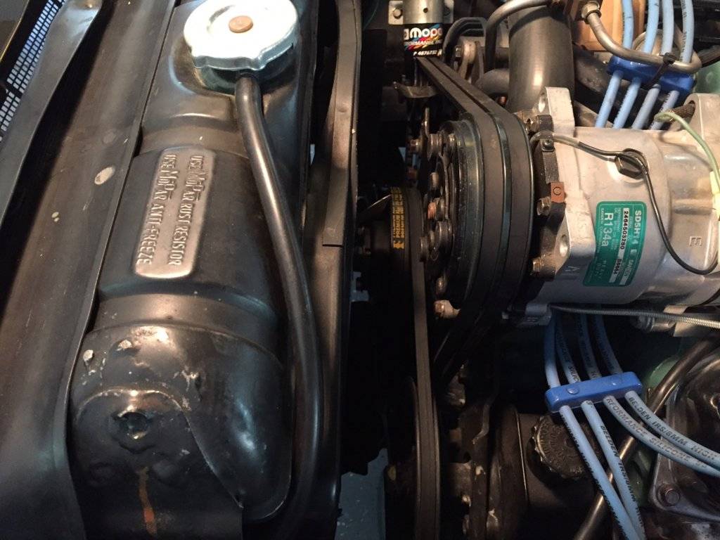

I'm using a Sanden compressor and new short Hayden clutch on my '62 with air. I'm using the factory pulleys with belts in the stock location. The fan is slightly more than an inch away from the compressor clutch. Not sure what's different between your application and mine?? (picture attached)
