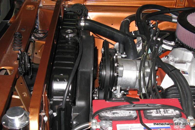

I don't know about that. Here's a pic of mine with the factory 054 radiator re-cored with 4 rows and the taller Hayden 2747 fan clutch.
Hmm, I'm using the same fan clutch. Does your car have power steering? Is the power steering belt in front of or behind the AC belt? The power steering belt on mine is in front of the AC belts.
My power steering belt is behind the AC belt. It sits between the AC and Alternator belts on the crank pulley.

I should say I did not install the AC on this car. It was done by a shop using a Classic Auto Air kit.
