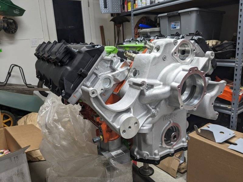

I just bought a 6.4 crate hemi, and I've spent quite a lot of time trying to get educated enough to make the right decision for a controller. I see that the Holley and Edelbrock controllers are tunable, but honestly, I'm not good with that sort of thing, and I'm just looking to stay with a stock setup outside of using the Holley long tube headers, so I'm wondering if the Mopar kit is the smart choice for me..... especially given that it will also come with my DBW pedal?? Any reason(s) why I should choose otherwise outside of tunability? I'm a total virgin to this hemi swap tech, but I'm about to learn!
I know you don't think you will tune your engine now but you will most likely want/need to at some point. The Holley system is widely used and known by a lot of tuners thus I'd say it is probably going to be easier to find someone who knows the program. On that point with modern systems a person can write a tune and email it to you and you can install it, not all that hard.
All this said, any of the good programs/tuners self learn so outside of the base tune it will sort itself out over time and with use (same as the Mopar one).

Well i also checked out the Edelbrock, and I see that it does come with a tablet that helps you set a base tune....I did like that, and initially I liked that it would work with a factory alternator, but I now see that my smart money is on the Holley mid mount with the one wire alternator so that's no longer an issue. The only other thing I see is that the Edelbrock has a tach drive wire, and I can't find anything about that with the Holley. I want to keep my stock 71 rally cluster and be able to run the tach, so that matters to me too, but then, the Holley system looks to be nearly $500 cheaper, so there's that too.
The Holley system can be made to work with your stock tach but will might require a MSD adapter which is what I used on my Challenger. Since you are using a G3 Hemi I am not sure though but I would reach out to Holley via email, phone or I believe they have a chat function during the day and ask about it, they are pretty responsive.

I do intend on calling Holley to find out about the tach options, as well as what you're getting for the extra $600 of the "premium" mid mount kit vs. the cheaper one. I honestly can't find one word difference in the two descriptions, so I need some clarification on that before I place my order.

I'm for sure going with the Holley setup for that. It's more logical, less invasive, and right in there with the cheapest possible option, so that part is decided. With that said, my biggest concern now is whether the Mopar controller will operate properly with no alternator feedback, due to having the one wire setup from Holley. If that isn't an issue, I'll likely go with the Mopar controller due to the ease of installation and having all the pieces I need to put it running without a bunch of costly add on pieces. I found that MSD makes a clamp on tach feeder that solves the only other thing I was concerned about, so it's all down to whether the alternator wires from the Mopar controller can just be dead ended. Hopefully I'll find an answer for that soon!
