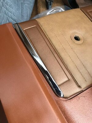

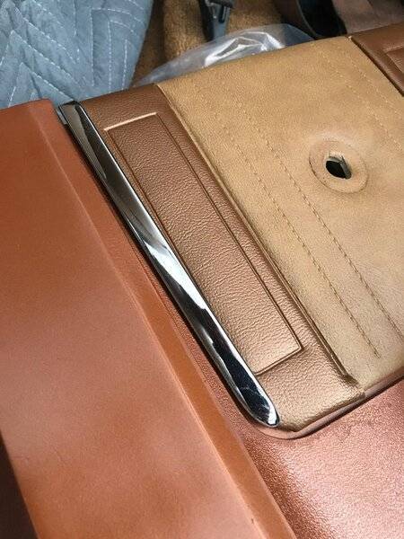

Does anyone know someone that might have this part for a 67-70 B body convertible. Its the molding for the rear upholstery panel for a convertible.

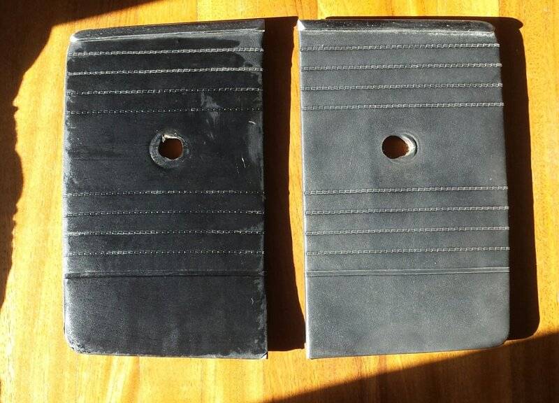

I have these 2 panels with the chrome
Nobody repops 'em. I looked and looked when I restored my '66 vert. What I ended up doing was getting a set of door trims then cutting them down. Then they would attach to the panel just like they do on the door panels.
