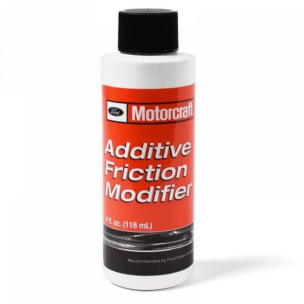

Save it. Put some 80/90 in. Your 8 3/4 have a Sure grip? You will need some Friction Modifier. Dr Diff sells it.
i will check it out tomorrow, where is Dr Diff?
You can get the friction modifier at most Ford dealerships.
