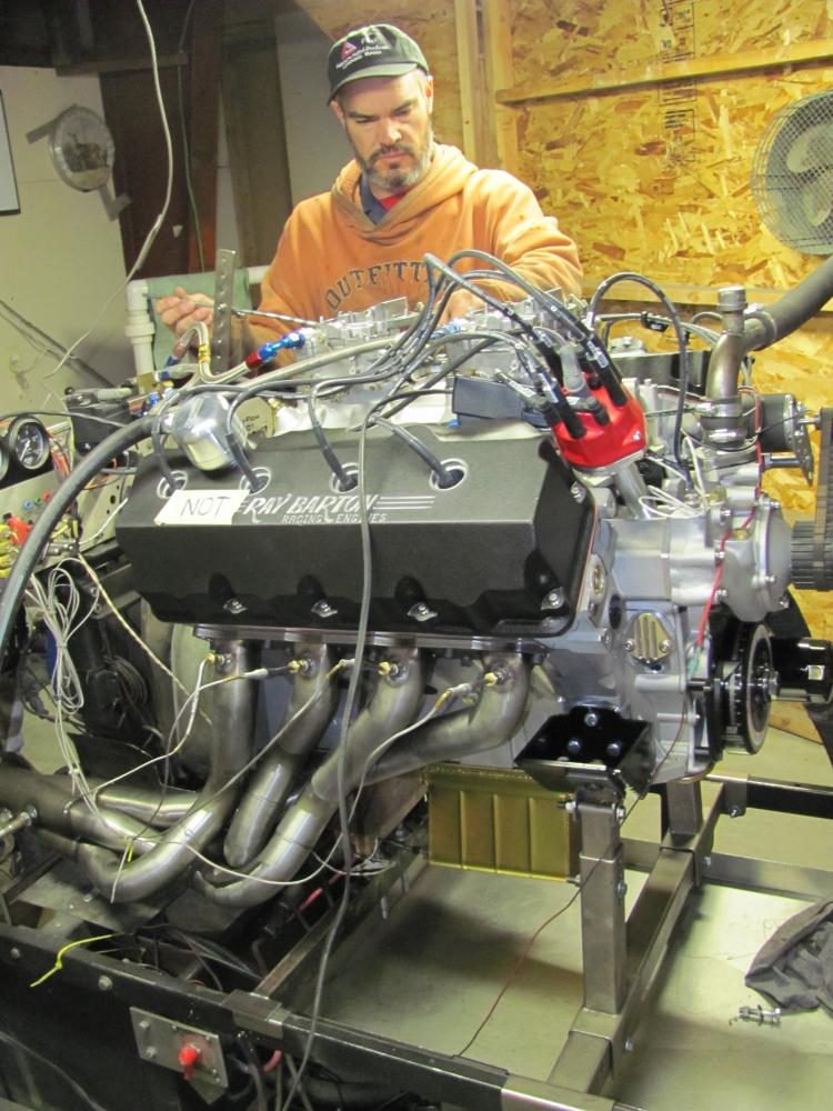

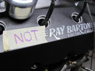

This is a pump gas 572 with 733 LB-FT and 784 HP. 12" vacuum @ 800rpm for the fuel injection that goes on it next.
The bearded wonder is my son, right hand man and head porter.

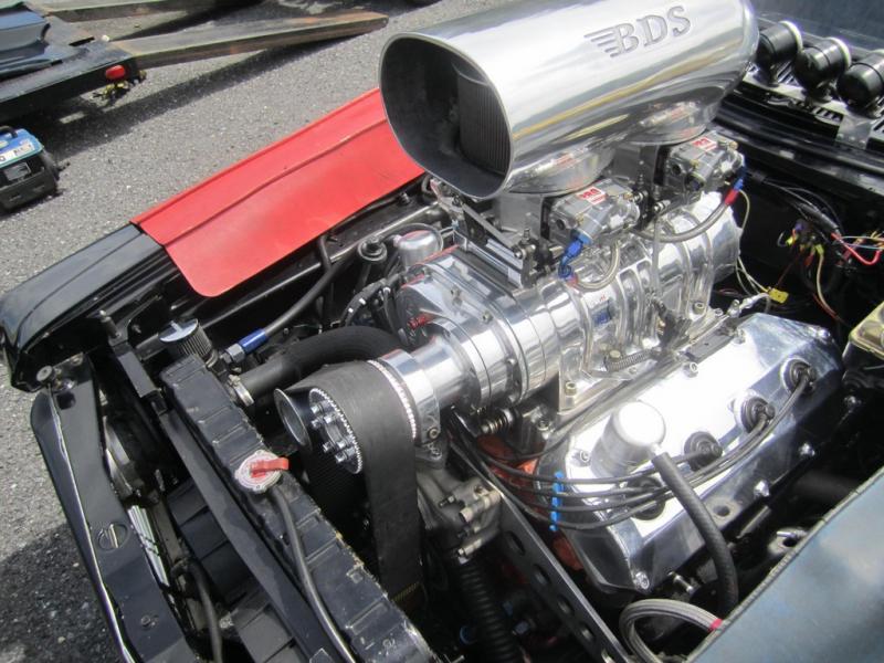

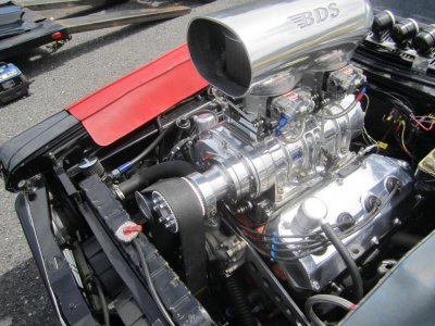

Currently have 2 all steel hemis up and running. One blown alky,one tunnel rammed. And just picked up 90% of the parts needed to put together an all aluminum,14-71 blown,dry sumped hemi. The latest one should be completed at total cost about 12-14k. Thats with slider clutch and lenco trans. And a lot of spare parts. All of these were abandoned projects. Gotta keep cash handy and eyes open.

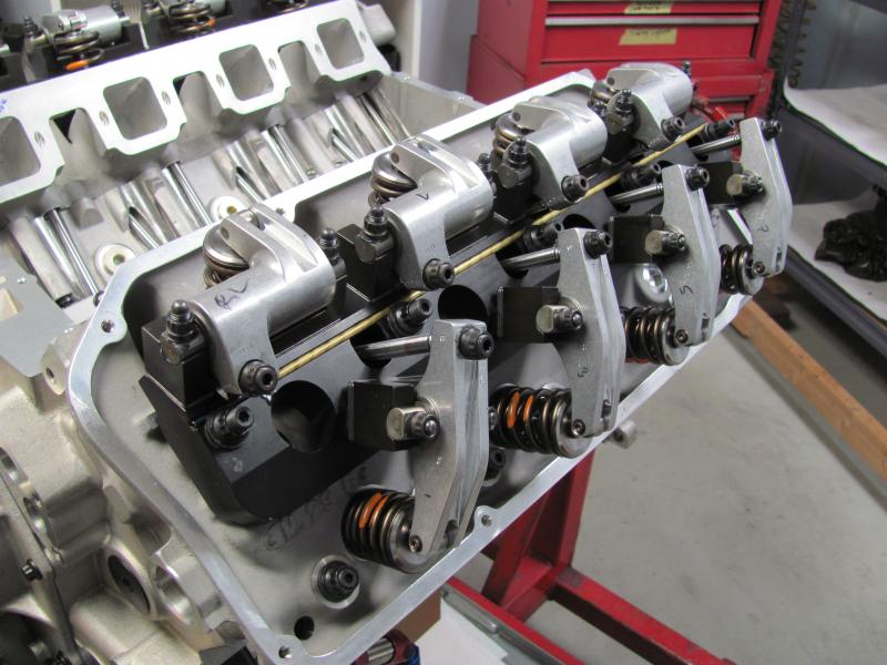

How do you like those rocker arms?
They are pretty and they have one heck of a lotta parts.
A real convenience is that you can install or remove one rocker arm at a time.
Ray and Dave were always polite when I could get in touch with them but it was almost impossible to get them to call me back even if they said, "I'll call you back in just a few minutes." I'd wait for days and call them back. I'm sure I was a real pain in the arse all the times I had to call to sort out rocker lengths, ratios and stand heights.
I had to strip all the assemblies and remove all the aluminum shavings from the fulcrum bearings and adjuster threads. The nuts that held the rockers to the stands didn't have enough machined clearance to the rocker fulcrum shafts and required a slight bevel to keep from pushing out some proud metal on the nut where it met the fulcrum. A different exhaust rocker location would have prevented some of the extensive grinding I had to do on the valley wall and the pushrod opening in the head so that the exhaust pushrods wouldn't rub on them.
I'll try another rocker system the next time.
The pushrod clearance issues seem to be with any hemi rocker system and block combo, so a full mockup is always in order. They're just a royal pain.
