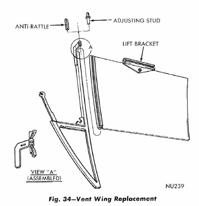

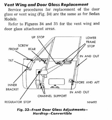

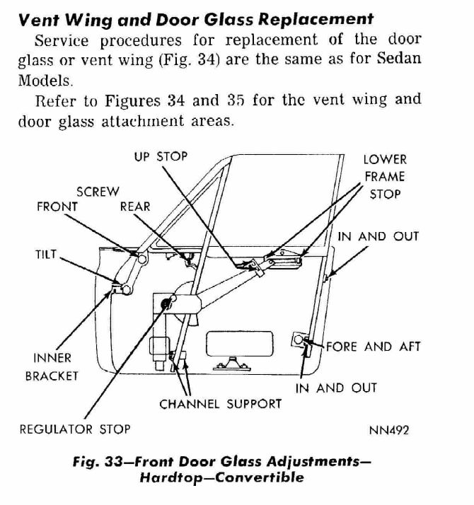

Iam from NWest Ohio. Have a nice 72 Charger-318/727 which i got in 06. Has a stoker kit and headers. Other than that It's a survivor car-all numbers matching. I could use some help. I just bought a 69 Road Runner. Taking it apart to send out for some new paint (last owner used Toyota Orange Metallic on it insteand of T7. HOW do i get the wing vent off??

Probably the same, here are a couple of vent wing diagrams from the 1970 shop manual:

Welcome....yup, you pull the whole mechanism out of the door then you can take it down further. Once you see how it goes together, you'll see how easy it is...so long as things are not all rusted up.
