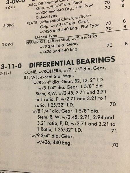

Im looking through my 70-71 mopar parts manual and was wondering what does r1,w1,b2 and j2 mean? I know the letters mean Belvedere charger barracuda and challenger. But what do the numbers one and two mean?
The numbers are a model designation, and six and eight cyl. cars were different models in the early cars, as noted in the VIN. The C bodies used 1,2, and 3 for different models, and the designation was in the early parts manuals. What I stated above is correct for A, B, and E bodies I believe.

They made six cylinder chargers? W1?
R is belvedere line.
W is coronet
B is barracuda.
J is challenger
Not sure about the numbers
