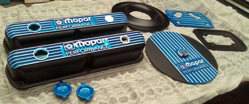

Does anybody know what grommets and breather caps will fit the knockout hole on a Mopar Performance cast aluminum valve cover? This is not the hole where you twist a breather or cap on and off its just the smooth hole.
I bought some from Mancini racing but the the O.D. is too big, the knockout hole diameter is about 1-1/8".
That same part number (without the Mancini MRE prefix) has been used on MP covers for at least fifteen years.
My valve covers are from 2004/5, could that make a difference then?
I will probably try the Ford grommets, today I will measure them again to make sure I didn't mess up the measurements. Thank you everybody for the information.
I always hole saw them out to 1-1/8". Hope you find one.
