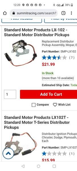

Hello,
So I accidentally fried the pick up in my MP
B eng distributor,
Replaced with Store bought Stander ignition. Brand pick up .
The alignment is not the same the MP one was centered on the reluctor tooth the replacement is sitting higher up and above about 1/8 inch up above the reluctor.
Will this eventually be a problem?
The Engine runs but seams to be harder to start then before.
Does any one have part number for the Mopar Performance pickup coil ?
I checked on Mancini and the show only the standerd ignition pickup And reluctor.
Should I get the standerd reluctor to see if the alignment would be better?

So I found the answer on summit.
I needed lx102 and got lx102 T miss boxed from Orielys autoparts
Fyi top one in picture is identical to Mopar Performance one. Bottom one does work but taller and not aligned.
