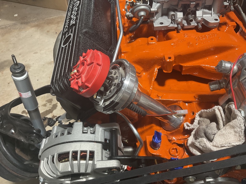

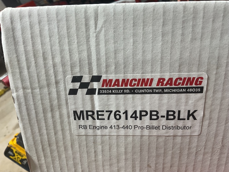

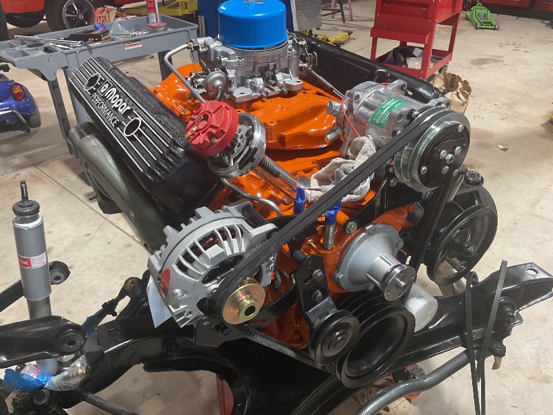

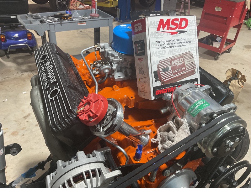

I have a 69 GTX that a purchased as an incomplete project. The 440 has been professionally rebuilt by previous owner and remains pretty stock, no performance mods from what I was told. The project came with many parts to complete the car to include a Mancini Pro Billet distributor and an MSD 6AL box. Knowing that I already have these items in hand, are they a good option to install? Or should I be looking at something else as an alternative? Is there any info out there on exactly how to wire up these into my stock GTX? Obviously some significant changes to factory ignition items, so I figure someone has gone this route and may have some knowledge I could use. I did search the forums and not finding much on actually wiring in the 6AL box.

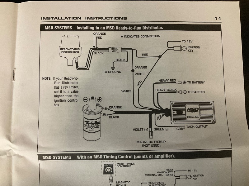

After adding a 6AL my 440 started easier and idled better/cleaner. Since you already have one, you might as well use it. The Mancini pro billet distributor is said to be the same as a MSB pro billet so installation should be pretty straightforward. I pulled out my spare 6AL and this is the wiring diagram instructions for a “ready to run” distributor.
You will need to eliminate the ballast resistor, for simplicity and to maintain a stock appearance I simply gutted a stock ballast and soldered in a wire between the terminals so the ignition circuit has a full 12 volts at all times. The wire that originally went to the coil+ terminal will become the keyed 12V in the above diagram. Depending upon where you choose to mount the MSD box, some of the wiring may have to be extended. Mine is mounted on the front passenger side of the core support so I made a harness for the heavy red and black wires and extended the 12v + feed wire in the stock harness.

I'm not sure this would be correct as it shows the magnetic pickup unused.
Pretty sure the 2 conductor plug leaving the distributor would be the magnetic pickup.
It doesn't look like a ready to run distributor from what I can see.

It is a two wire plug on distributor
Then I'm almost certain those would connect with the Violet and green. (My guess is orange would be +, black -)
You can connect everything and simply spin the distributor shaft with your fingers and check the coil wire to ground with about a 1/4" air gap. Check is start and run position on the key.
