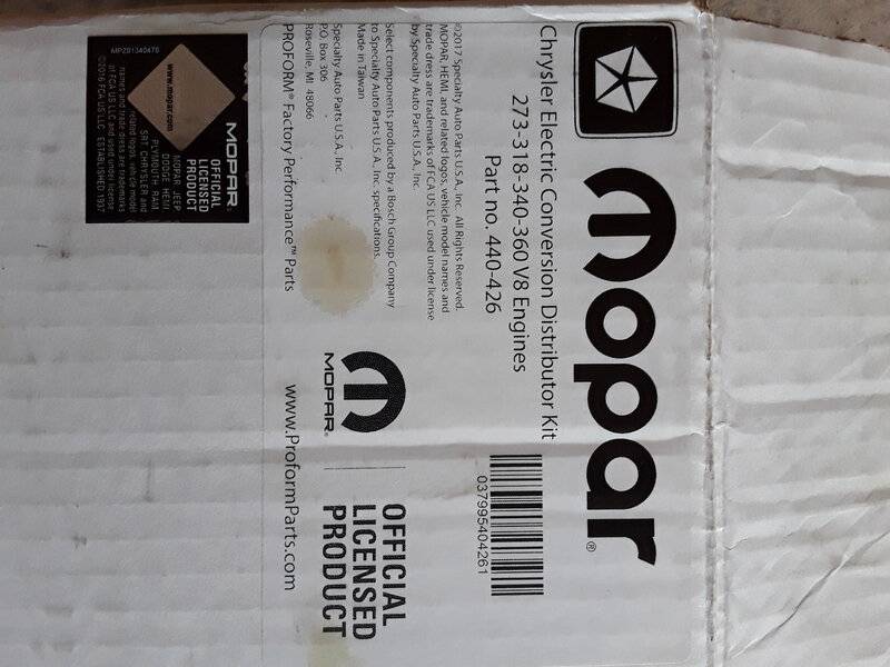

Does anyone know who's making the distributors that Mancini and others are
selling as Mopar Performance Distributors. It looks to me like they might be
Proform but not 100% on that. Also, what type of internal mechanical advance
mechanism do they have?
Thanks. RR
I bought this kit a few years ago but I think they are still being made by Proform. Check the part number.
Interals look about the same as a stock distributor but I have not had it fully apart. Springs are light and advance is all in by 2200rpm. Vac advance on these is also pretty bad. I think I measured about 5° crank timing total compared to the oe 340@ 15°. I think rebuilding a stock distributor is a better investment to be honest. Out of this kit, the only part that has not failed is the distributor, and I am planning to replace it with a recurved rebuilt stock dist.

Yeah it says produced by Bosch, made in Taiwan. I'm sure if it were made in their German plants it would last forever, run like clockwork and be 10X the cost. Pick your poison I guess.
