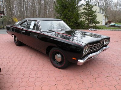

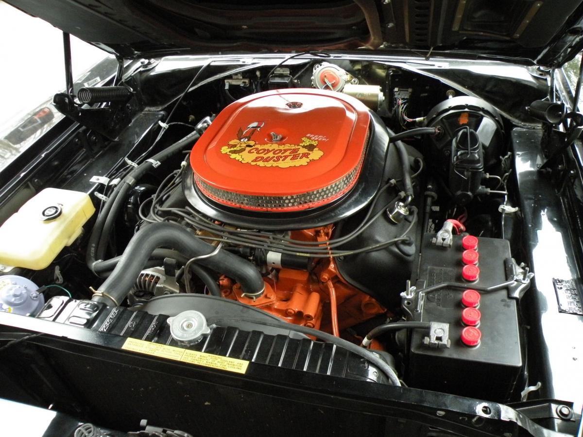

my repro battery has a hard time cranking over my 69 hemi roadrunner.its brand new.

I was looking for a very long time for a 70 triple black 4 speed hemi Roadrunner, and then the hunt for a 70 roadrunner 440-6 convertible 4 speed but came up empty. 70's are a favorite of mine.
took me over 25 years to find my 69 hemi roadrunner. thanks fior the kind words.
