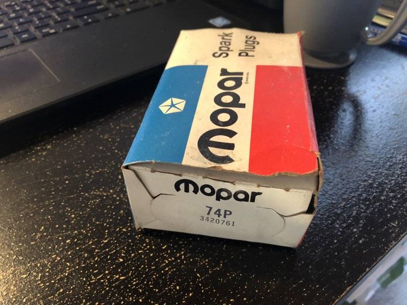

found some n.o.s plugs. can anyone identify what year/ model they fit ??

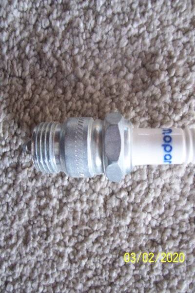

Can you provide a few pix of an individual plug not in the box or wrapper. It is likely that the plugs are 3/4" reach plugs for the 360 engine or possibly a latter 318. OR they may be 1/2" reach TAPER SEAT design for the later slant 6 engines. I cannot seem to find a cross reference with Champion or AC or NGK but my info is not current.

they are tapered & 1/2 inch thread. I have boxes of them. some are blue mopar some are red mopar
IMO...
They are for the /6 engine, I think begining for the '75 - '76 model year, when the head was designed to replace the 3/4" reach spark plugs and the aluminium tubes, and catalytic converters became standard. They are a moderately hot heat range. The plugs were manufactured by Champion Spark Plug Company, for Chrysler Corp (blue labeling) and Mopar Parts Division (brown labeling) or possibly CRYCO (Chrysler of Canada). Champion usually cadmium plated the steel shell to prevent rusting. Possibly equilivant to Champion BL-15Y or AC R44TS. Recheck yourself to be ABSOLUTELY sure.
BOB RENTON
THX you for your research. I just happen to buy some parts & they were in a box. not worth anything except for show on some ones shelf.
