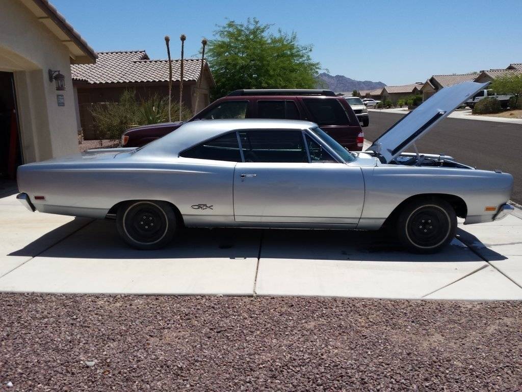

I have the 456/457 3400lb springs on my 69 GTX and it sits pretty levelalthough the front is raised a touch because of the deep sump oil pan.

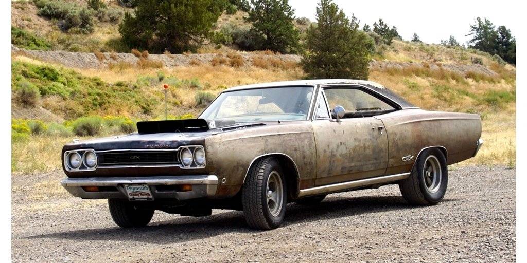

I put the P4452982 and P4452983 on my charger and you can see about 2" above the tire. They are going back to Summit. Super stiff by the way but I'm trying to lower the car.
max340 are those 3600# springs? I'm looking to replace in the spring. Neither outlaw or threewood looks objectionable to me,but that's just me. Also you have to remember they will sag a little after a year or two. Jeff

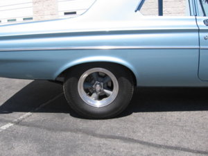

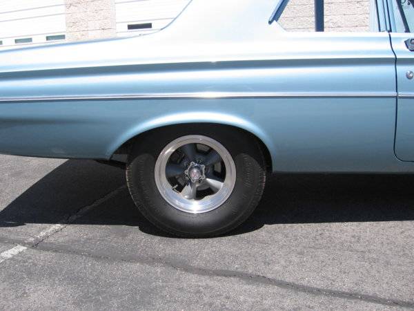

I have the 3400 lb Super Stock springs I bought from Mancini and this is how my 63 Sport Fury sits as this pic was taken a few months ago. Ron

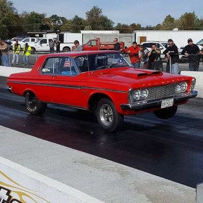

And this is the car launching. It actually did not hook good on this pass as my 60 ft was bad on this pass. You can see it always lifts the left front tire a bit more then the right front but the car goes nice and straight all the time. Ron

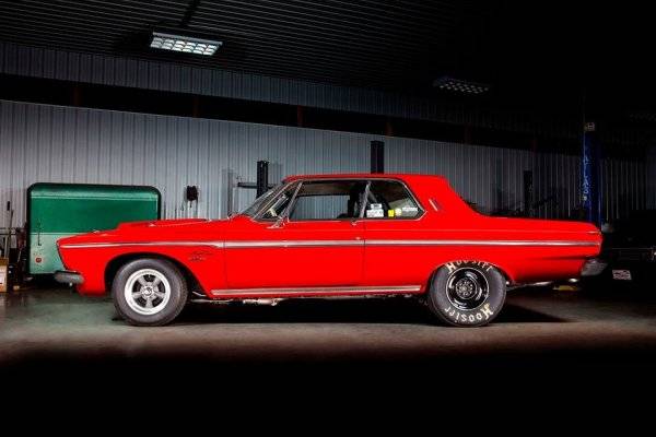

Yea as my 63 goes like 3725 with me so I also went with the 3400 lb springs. When I ran a 3300 lb A-body I ran the 3000 lb springs the 002 & 003 springs. Ron
