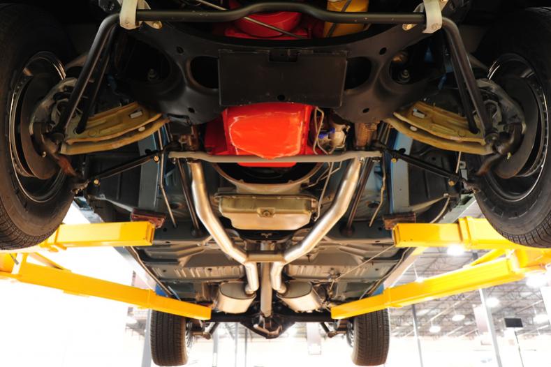

Just found these pics. From a restored Hemi Charger 500. Looks OEM correct but don't know for sure. Check out the Link for all of the cars pics. 173998_3f094da4bf_low_res.jpg174000_f8a1c9f778_low_res.jpg
http://www.rkmotorscharlotte.com/sales/inventory/sold#!/1969-Dodge-Charger-500/133015/174000
I believe that is too deep of a pan to be OEM. I like it though. anyone disagree?
That is for sure an aftermarket deep pan but a nice one, doesn't look like the cheap repops.

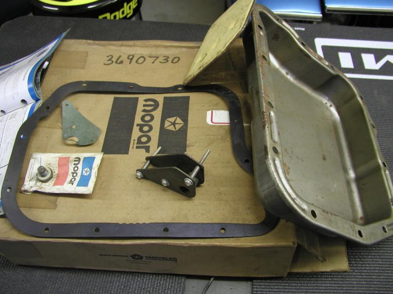

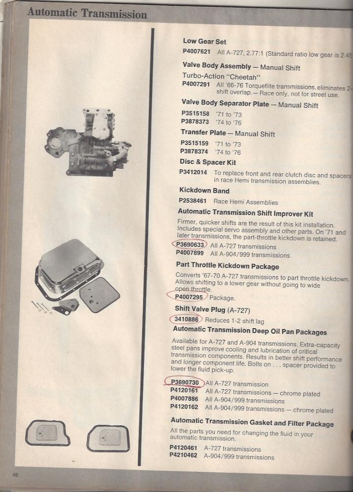

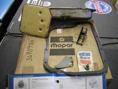

Looks just like the old mopar performance pan I have on my 65 coronet, Was a deep pan and came with the aluminum spacer for the filter. Was Mopar performance part number P4120161 the chrome pan, and P3690730 for the unplated version. They also made both for the 904 trans too. Early 90's if i remember right...
1983........
P3180001.jpgP3180002.jpg1983 Direct Connection Catalog P83.jpg1983 Direct Connection Catalog.jpg

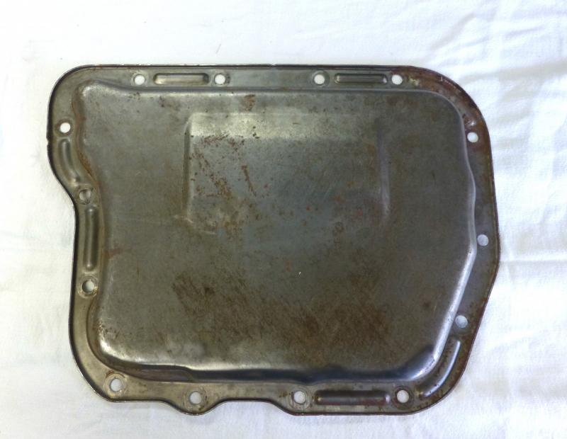

OK Thanks for the input. Like I said the 69 parts book is confusing as it says "with plug". Here is a pic of what I am going with. I believe it is the correct one and was told it is off of a 69 727 with a 383. Let me know if anyone disagrees. I plan on cleaning it and getting it re-plated.
