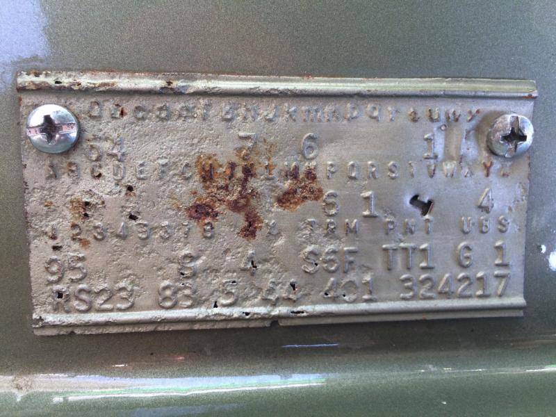

Hello, trying to decode the fender tag on a car I'm looking to purchase. This is what I was able to glean using online resources ( and kudos to those people for making those available). However, there appears to be some inconsistencies - my attempted decode indicates a/c as well as rear radio speakers; the vehicle I'm interested in has neither. My result is below;a picture of the fender tag is attached.

Im hoping one of the gurus on the board can confirm or refute what I've found.

I can confirm that may not be the fender tag for that car... Please check additional locations as these were not attached with screws..
Icecobra, thanks for the quick response;can you advise where I would find the additional locations? I'm aware of the drivers side trunk lip but could not decipher what numbers where there (Covered in paint). Or are they actually underneath the weatherstripping?
my 68 gtx tag was attached with screws..... it was unmolested
look for the number "324217" on the radiator support and drip rail. If it is, the tag is correct.
all my 66's and my 70 is attached with screws....just not that style in the above picture
Your decode indicates R/1 (AM Radio) as S/1 (A/C). Easy mistake.
The punch through #1 is an inspection punch, not a code.
The speaker could be missing. Check for factory wiring in the trunk/package tray area.
Look for G8R324217 on the radiator support. As this is a St. Louis built car (RS23L8G******), you may need to look on the engine side.
The tag would have come from the factory with a different style screw.
