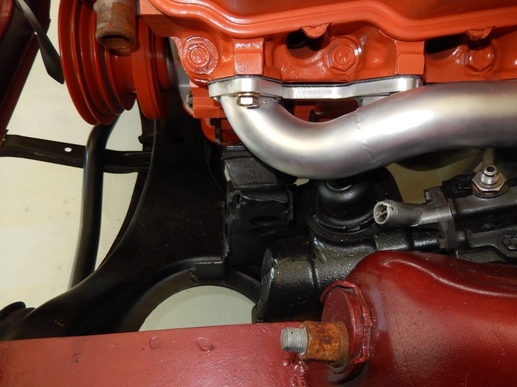

I sort of got it down on the mounts, but it just doesn't seem to sit right. I followed this:
http://engine-swaps.com/Pages/InstructionPages/B63V8.html
which shows them to the back of the engine. It appears to show the rear ears lined up pretty much with the two insulator bolts, but mine doesn't line up that way. the trans is bolted to the engine and the trans mount in the back so I can't really move the engine fore and aft. Maybe I'll post some pics tomorrow, I'm exhausted and need a beer.:D
I'm thinking if you have an original poly 318 it will not be the same as the conversion mounts.
Thanks for the link kryslerkid. I missed that because I searched for "mounts" instead of "mount".:rolleyes:
Initially, I had the engine in, with the brackets in front of the ears, and the mounts were canted (see pic below). That didn't look good so I lifted it up and put them both behind. Well tried anyway. They don't line up well that way either. I'll have to mess with it some more tomorrow afternoon (first chance I'll get) and see what I can figure out.
