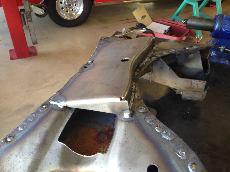

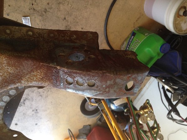

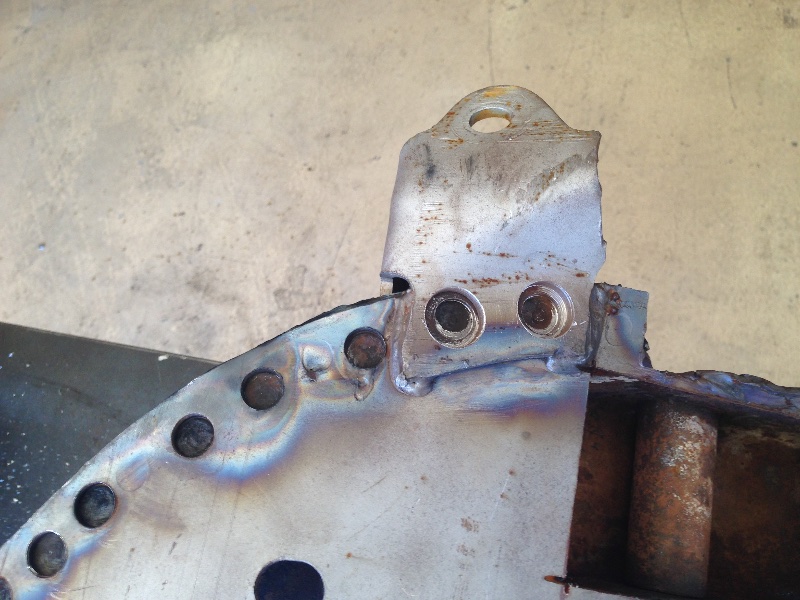

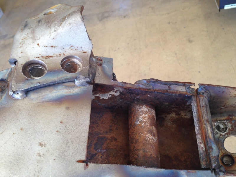

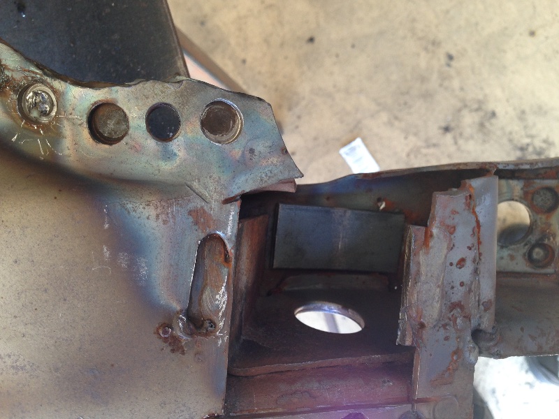

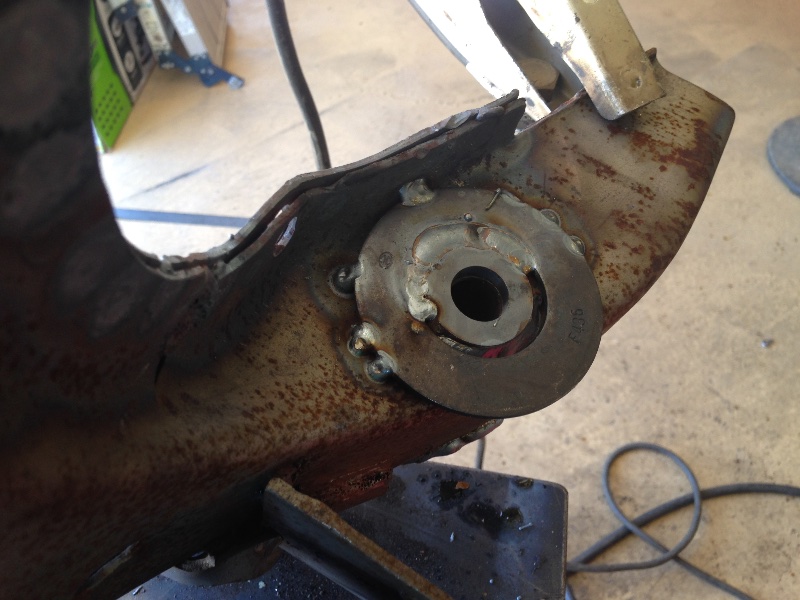

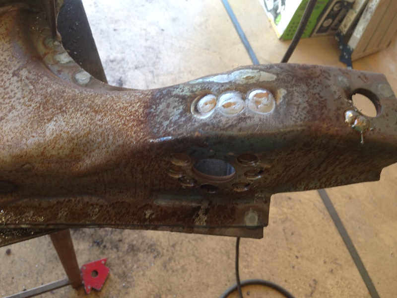

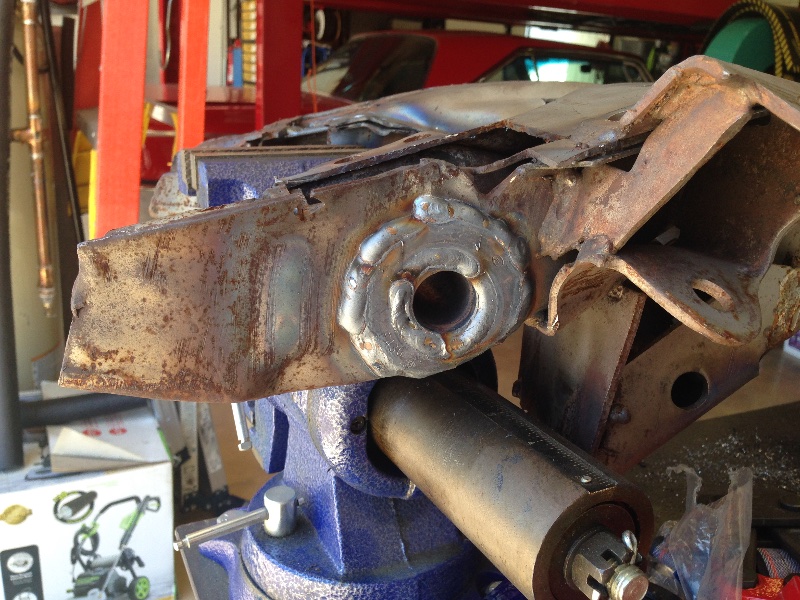

In pic number 4 it doesn’t look like u left enough room for the lower control arm pin to fit against the K. KimFor my 65, I'm using a 70 unit. 3 reasons why I chose that over the 65 one are: double shear mount idler arm[ also easier to source for replacement] as its stronger than the bayonet bolt unit, pass through the frame sway bar mounting, moves the engine back 1.5". I did extensive welding, reinforcing on it. The usual areas like for the lower control arm shaft but even more extensive, steering box mount. I also boxed in the strut rod mount area. On the perimeter spot welds, there were around 30 from the factory. I added 120+ to that. Some of those are in the idler arm mount area. Lots of hole cutting with my Blair Rota Broach cutters. Pieces of metal I have in my stash plus my Lincoln Mig unit. Very little cash outlay, buts lots of time. As Greg and others who are into construction point out about shear walls and nailing patterns for such, my added welding was essentially making a stiffer unit like more nails in the shear wall.

Good info. Thanks for mentioning this...I will definitely do this to the factory K-frame.Other than cleaning up the welds and stiffening the steering box area. The only other things I would consider is reinforcing the strut rod holes and replacing the press fit pitman arm attachment flange with a 68-70 u shaped yoke style attachment. Much less flex and better pitman arm availability if you want to use the longer pitman arm for faster ratio steering.
I made sure the shaft fit. All good. Thanks for the keen eye!In pic number 4 it doesn’t look like u left enough room for the lower control arm pin to fit against the K. Kim
