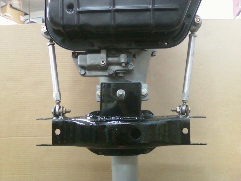

Do you guys have any pictures of your fore/aft limiters? Only using one or one on each side of the engine?

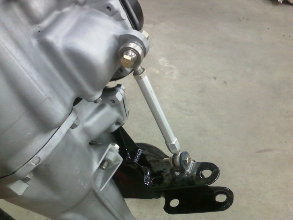

I just have a steel tube w/ a heim joint on each end (Comp. Engineering kit). One end is bolted to an existing lug on the back of the trans case, just above the pan rail. The other bolted to an "L" bracket I made that's bolted to the trans crossmember.

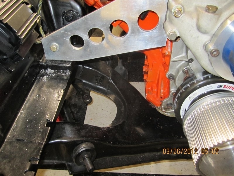

Use a plate ,the ears can flex from not being tied together. the plate actually hold sthe motor better than the factory mounts when done correctly. i like to tie the plate into the front cover at the bottom bolts. When using a plate you should have a control for fore/aft movement as the plate isn't as strong in this direction. You can attach at the engine or at the trans as I have here. Standard trans mount works fine.
Midplate is the next step but in a standard chassis door car they can be hard to fit around the headers. Mine has been fine without one to 9.0@151.

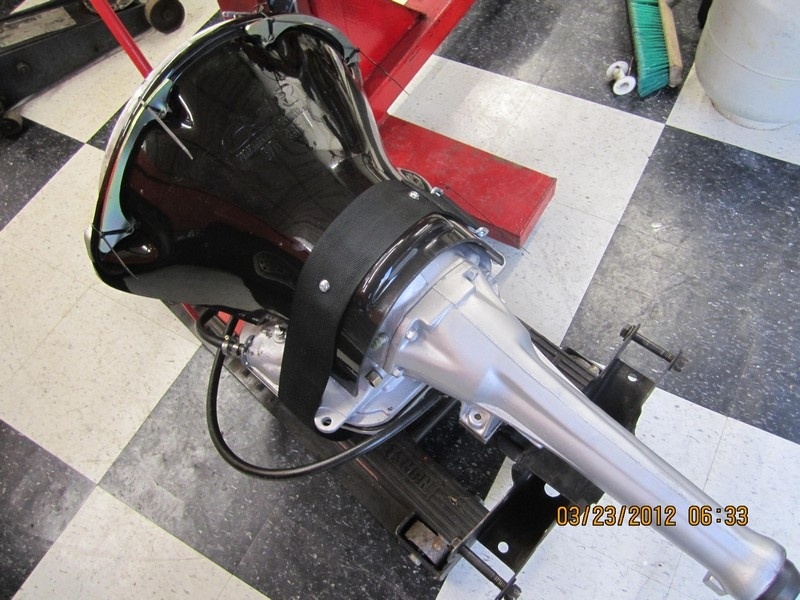

Dvw,that certainly is a full plate ya got there. Here is elephant ears bolted to a saddle held on with a band clamp. The midplate is a bit more substancial.

DVW has proven to be that his method was do-able.I've been told NOT to do that way as it can break the ears off the trans.I first put Elephant ears on my car about 20 years ago,had to tighten the water pump bolts every time I was in the engine compartment and put up with fixin leaks.
Swithed to a thick one piece plate and that's the way it's been for 15 years.So I will install limiters that way and even PAINT my crossmember,,,,,it could use a fresh coat....LOL

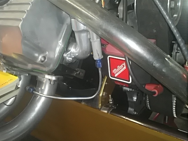

I have one limiter, attached to the engine-block and k-frame.

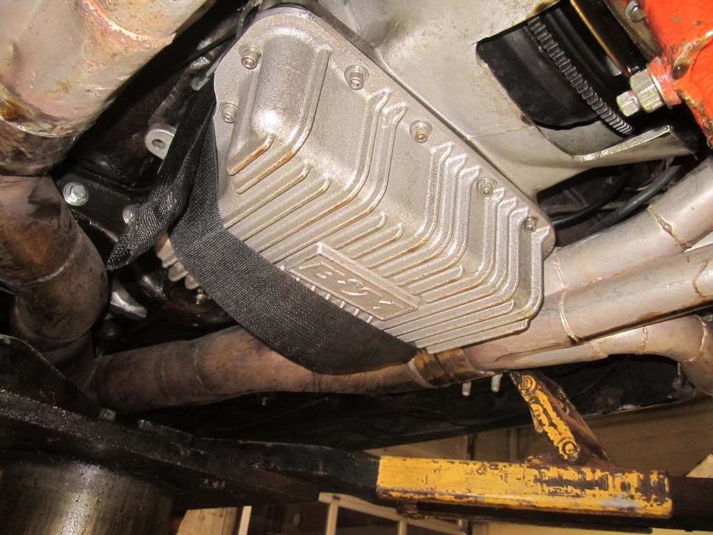

View attachment 331218 View attachment 331219
To be honest when i did it that way I couldn't get an answer. whether it would work. If you don't try, you won't know. It has passed it's initial 300 run trial.
