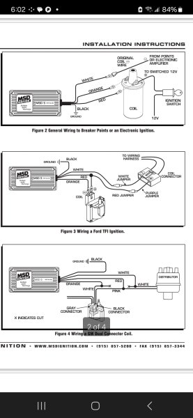

So i recently picked up a old msd 5 box, tested it out with a coil and it works great, question is how do I wire it for a stock mopar electronic dizzy, i know the red wire is power, black is ground, orange is negative side of coil and white wire is what triggers the box, on my dizzy I have a orange and black wire, would the white wire from box go to the black wire off the dizzy ??, and also does the orange wire from dizzy just get 12 v power. This is not like the 6 boxes where you have the purple and violet wires i believe the colors are, thanks for your guys input

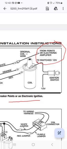

Yes i have this diagram, problem is i do not know how to wire up the orange wire out of my dizzy, it also says msd 5 will not trigger from MAGNETIC PICKUPS, i want to make sure the original mopar electronic pickups do not use magnetic pickups,

Well, Mopar electronic ignition distributors use magnetic pickups. I’ve never heard of a MSD-5, but the first diagram shows it connected to points. Why would somebody add this to a points ignition? I’m way out of my league on this one???

The instruction sheet in post #2 says the -5 will not work with mag triggered dists.

I just checked my old MSD catalog & learned something I did not know...
Two versions of the '5'.
MSD 5 & MSD 5C. The 5 is a universal fit but will NOT trigger from a mag p/up.
The 5C is for Chrys elec ign, has the 5 pin plug.
