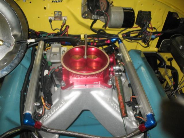

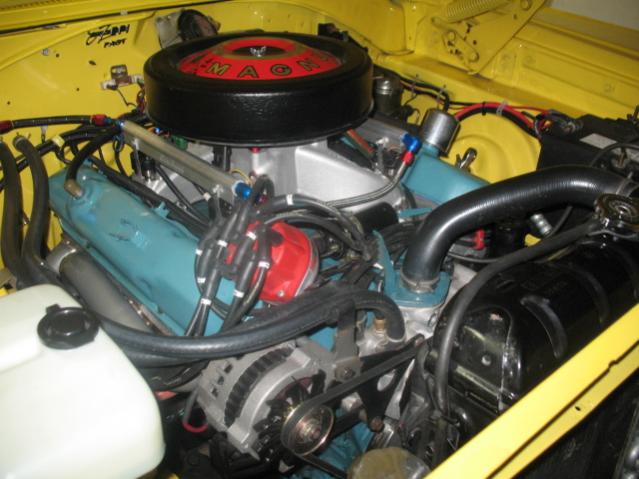

I just got done with the maiden voyage with the MSD Atomic EFI. All I can say is WOW what a difference so far. Still a few things to work out but overall very happy with it. I am running a .030 over 440 with 11:1 pistons, .590 lift solid roller cam with roller rockers, ported, polished and shaved Edelbrock heads, Edelbrock intake, TTI 1 7/8" headers, TTI 3" exhaust with 40 series 2 chamber mufflers, MSD ignition, and now just added EFI ( took off a 830 Quick Fuel if anyone is interested in it) in a car with a 4 spd and 3.91 gears. Installed the high horsepower pump kit with a return. I might change it over to the Aeromotive phantom pump later but for right now it works well. Had to upgrade the charging system because of the draw from the pump and glad I did because now I got to install my electric fan set up from Wizard Cooling which is cool as ****( 4 9" fans that move a lot of air). I have the MSD controlling the fans and the fuel pump and with the upgraded charging system what a difference. So we took a trip that we did last year and I just remember how much fuel it cost not mpg. Last year cost $130 this year it was $70 and much more enjoyable. The throttle response is great and idling is great too. I think the best part is jumping in and turning the key and she comes to life and idles. No more pumping the gas, letting it warm up. Just get in and go. I usually don't post anything on stuff I have added but after this experience I just had too. The install was easy once I figured out where to mount the pump and the control module. All in all very easy and definitely worth it.

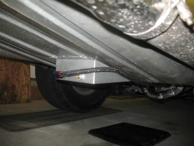

sounds very interesting. How did you manage to get the "return line" into the tank ? Came the "KIT" completly with all the stuff needed..or did you had to buy some more parts ?

I had a sending unit already installed with 2 fittings, when I was running the carb it was blocked off, so I ran the supplied -6 hose to the back and reduced it to 5/16 fuel hose and clamped it.
I actually had to buy 3 different "kits" and then a couple fittings. I bought the throttle body kit without the pump, then I bought the high horsepower pump kit which came with 15 ft of push lock -6 hose , and the regulator kit which also came with 15 ft of hose. The extras were less than $100, some more 90 degree fittings and then a -6 to 5/16 hose barb.

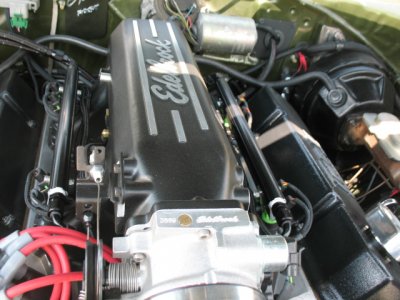

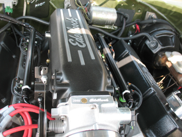

I ,ve installed the Fast Ez efi in my 496 Super Bee and quite happy with the results as well,some tuning with the hand held,upgraded charging system to maintain 14.0 volts, MSD 6A ignition etc.My upgrade was to port injection and 42 lb injectors.
I sumped my gas tank and used the sender as the return.I,ve noticed smoother idle,throttle response,mpg improvement .I like the monitoring and tuning from the drivers seat .

Beautiful. Is that the Vic EFI intake or you have bungs welded into a base Vic?
Info on the alternator upgrade?

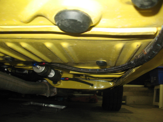

How you like that fuel line?
I've been considering a port system as well...

I purchased mine from Competition Components in Michigan. Scott has different kit forms available afford-ably priced. The tunnel ran Edelbrock will fit under the stock hood as was seen at New Hamburg Moparfest last summer

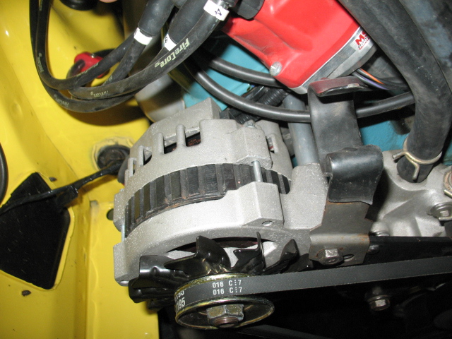

I used a GM CS 130 single wire alternator picked up from a local starter -alternator repair shop,modified the shims to align the belt and a straighter lower bracket. The fuel line is efi rated in fastened a long side the 3/8 hard line. Easy to instal but pricey using Russell 6an fittings

It wasn't exactly a weekend project for me as i added new 3/8 supply and return fuel lines and added an in-tank electric fuel pump assembly. i may have purchased the Aeromotive in-tank fuel pump assembly if it was out during the time of my install. Ohh well....will do on next mopar.

Anyhow, after research i found that using an efi system with a single supply line and in-line fuel pump ran the risk of pump overheating (i saw this on all brands of efi systems) as well as trouble with hot starts. So, i knew going into the upgrade that i was going to run new 3/8 supply and return fuel lines (hard lines) and install an in-tank electric fuel pump. I knew adding both of those pieces to the fuel system was not going to make this a simple weekend project so i was prepared for that.
For the pump i used an tanksinc.com pa4 in-tank pump system with a summit electric fuel pump relay kit that was being triggered on by the Atomic power unit (i think that is what it is called). Since the time of my install Aeromotive came out with an in-tank fuel pump system called the Stealth 340 i think. Had the Stealth been out i may have used that one. However, there have been zero issues with my tanksinc one and it uses a Walbro pump (a very respected/reliable brand).
