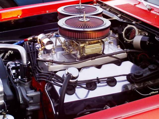

nice engine there 68 hemi-!

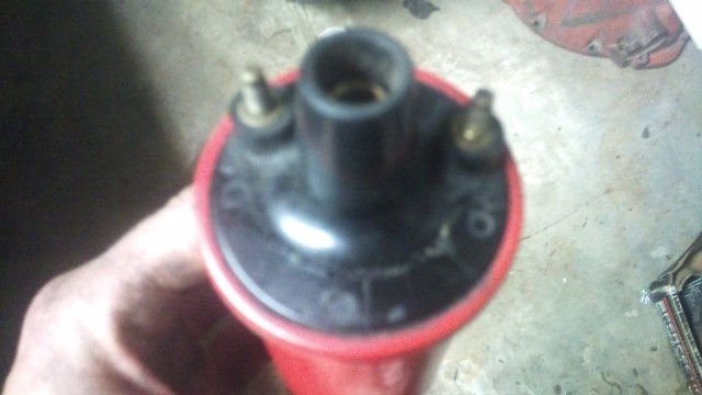

It would be my luck That I'm the only one so far that has had one fail. I had this one mounted horizontally on my mustang for about a year. One day on my way home from work it started missing, so I pulled over and found this blaster 2 coil spiting oil out of a big crack in the top.
