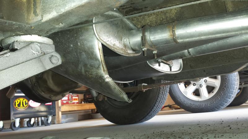

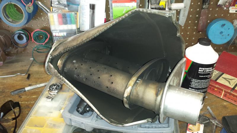

Worked on the front brakes this morning, didn't even touch the engine. Go to start it an hour ago and BOOM!!!!!! followed by smoke. First thought was I blew the engine, everything looked good. Neighbors were ready to call the fire dept. lol. Pulled the primary and spun it over, no problems. While looking under the car I found the carnage. I was laughing so hard I cried.
It is a Jegs exhaust system, non welded chambered muffler. No obstruction in the tail pipe that I could find. Too much fuel, and from where?

I'm still giggling about it. And my ears are still ringing lol. I have driven it 3 to 4 times a week so I doubt a mouse could have set up shop in it. Luckily I had a fairly new Dynomax Ultra Flow in 2" from my old single exhaust, chopped the ends off and welded on two female 2 1/2" pieces and got it back together. Straight through design so I hope it alleviates any chance of a kaboom.
Said a prayer and twisted the key, started on the first rotation without issue. Drove it around, laid some rubber. Sounds good. But I will be nervous everytime I turn the key, kinda like a mobster who has a hitman after him lmao
