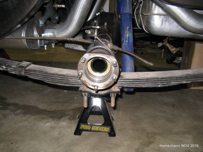

Long ones that came with the TTI 3" header back kit.
Here's the only photo I have showing how far back they come.
