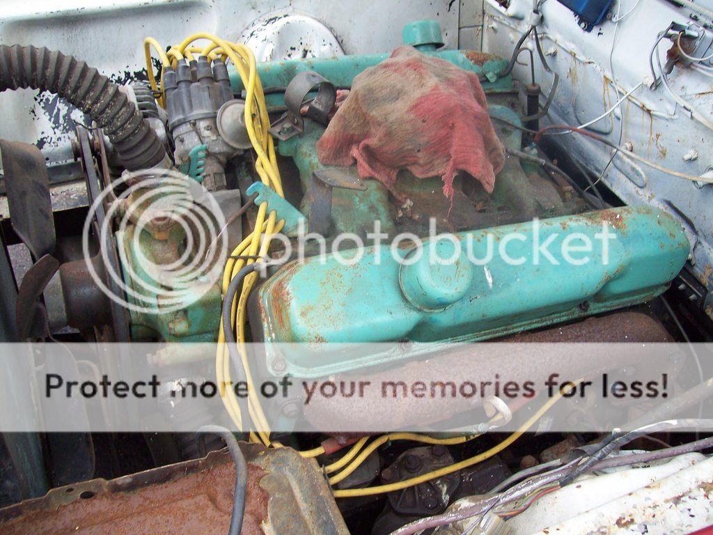

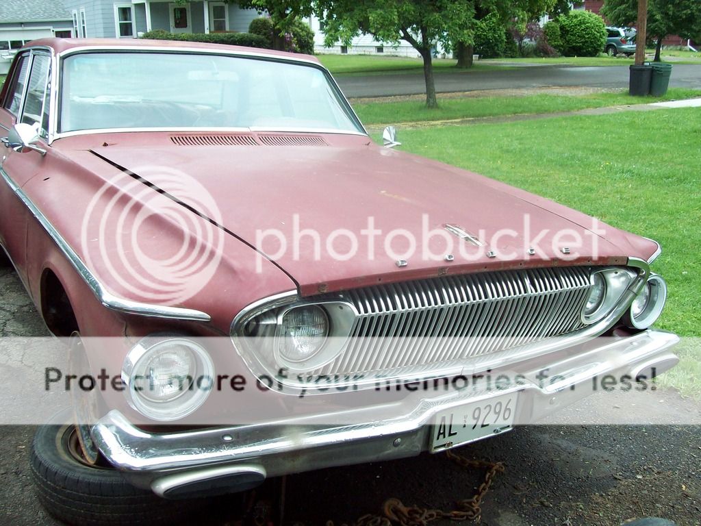

im trying to resurrect this 440 4 door sedan ive just rescued from a field,the paperwork shows last time onroad as 1982...needing a bit of advice.

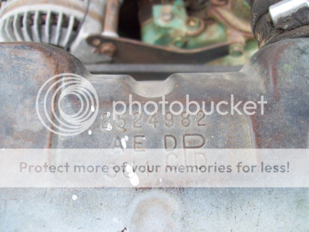

it appears to be a 1965 383 motor and maybe? a 65 trans as well.
the block id is
A 383 with a maltese cross
12 142
R
casting number is 2468130-4

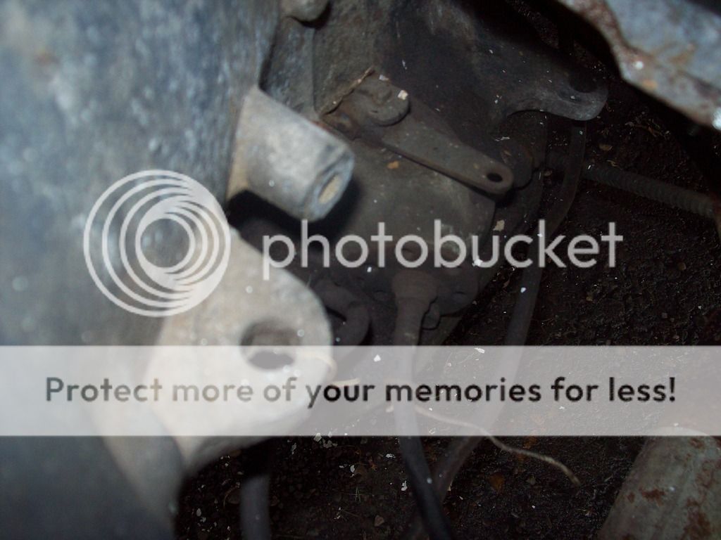

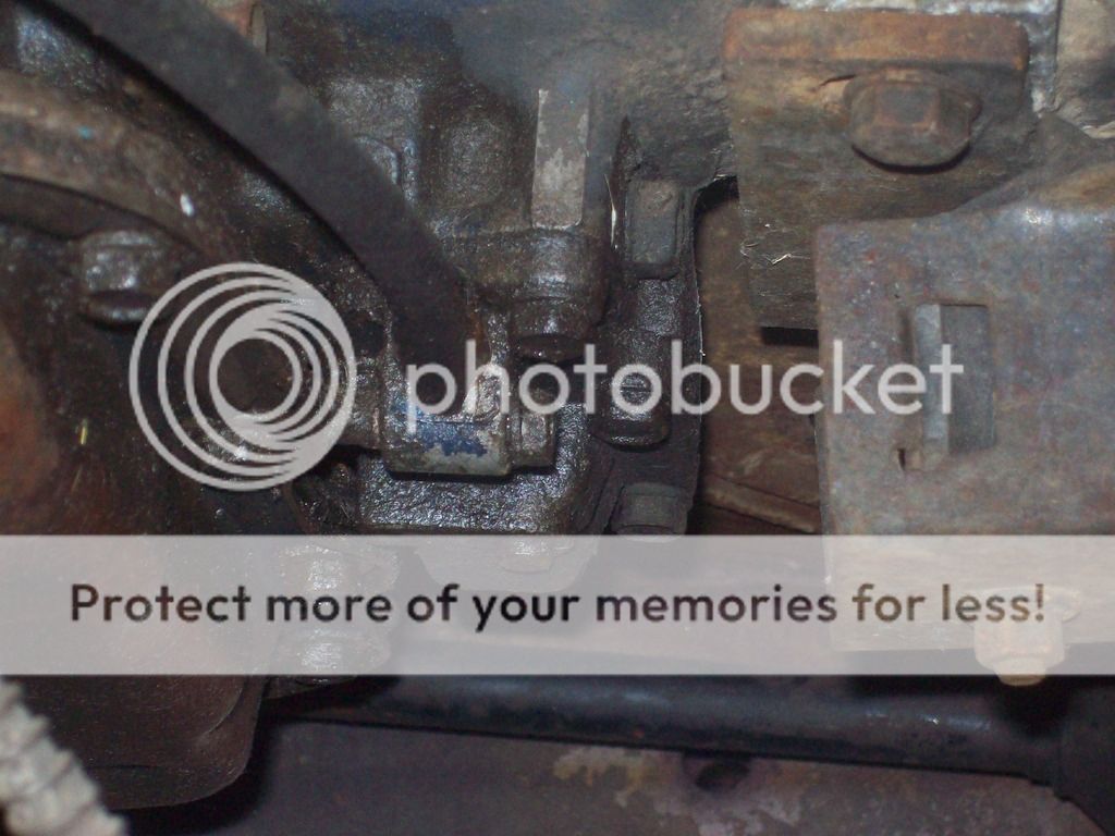

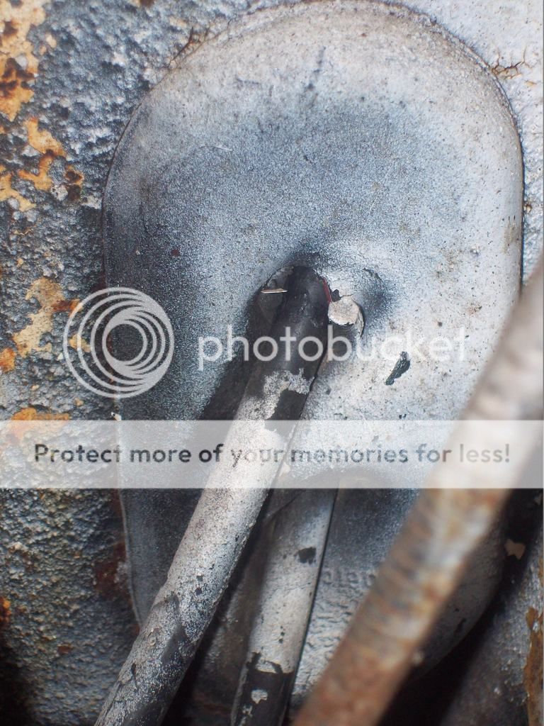

i cant find any info on the trans,so ive included pics of the cables? going into trans- front and rear.

ive already noticed neutral seems to be stuck inwards.

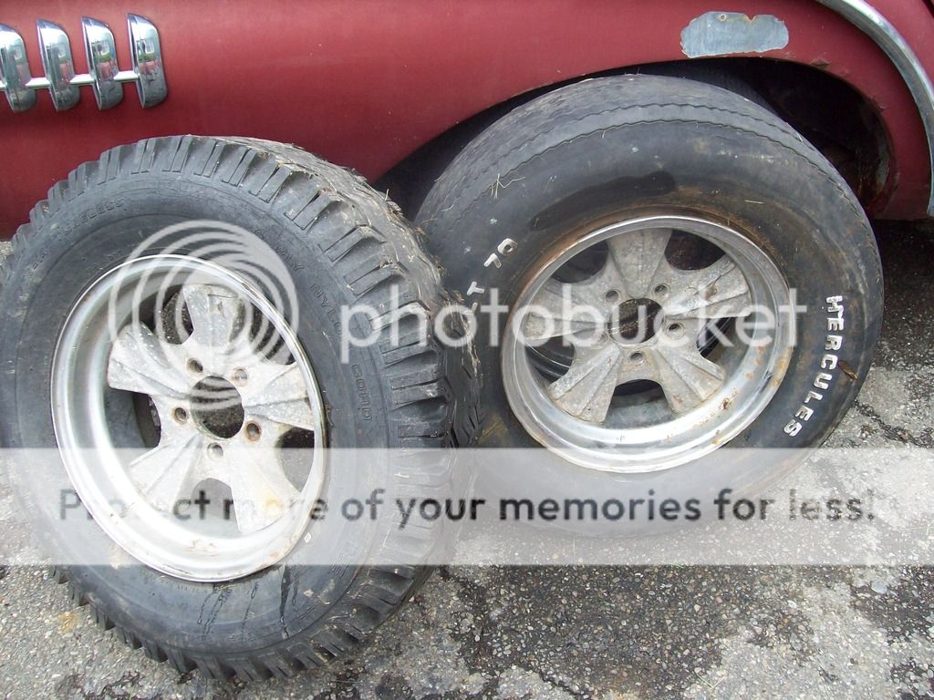

at the end of the pics im including a shot of the rims i thought would look good on it,but the bolt pattern seems to be chevy.
anyone know what brand the mags are?
i looked on the back and didnt see any marks??
I would install 4 bbl carb, duel exhaust. I can't help you on rear, 62s had the narrowest from factory,a body used 7 1/4 rear, completely different. Transmission would be the same 62-64 65 has rear slip joint on drive shaft. It sounds like trans needs to have front cable adjusted. On front cable see the wheel with all the holes in it? remove bolt that goes though it, turn wheel counter clockwise several turns. Have someone push reverse button in and hold it bottomed out, while button is held in turn wheel clock wise until it contacts trans case, reinstall hold down bolt. You have just adjusted shift cable. This should take care of problem with button, if not pull cover off of buttons and reinstall buttons in shifter. The wheels are Raiders very early style of after market wheels.
That is a good looking car for a beater.
yeah i thought so too.
he wanted 1800 at first which i declined immediately and then lowballed him @ 800.
then i looked at the car,its got rust and carp patch panels on the floor,but..who cares,ill patch it right and then drive her.
we settled at 900,for the car,a gas powered air compressor,a set of Firestone wide ovals,a bunch of small engine stuff/rototillers etc etc,and a brand new edelbrock 1406 carb in the box.
i think we did all right :)
now i just need to find all the chrome and some wipers....
and TY also,for that info on the cable shifter,i talked to a fella today who was explaining that.

I would suggest http://www.bouchillonperformance.com/torqueflite_cable_kits if you are missing the kickdown linkage. I'm using it in my car and it works great and easy to set up.
If it's going to be a street driver, why don't you get it running and driving, see how you like it and then decide if it even needs to be modified.
Badlite's trans cable adjustment procedure should get you going. If you don't know already you'll need to release the parking lever by sliding it to the left to release the "stuck" neutral button. When the parking sprag is set (rear cable on transmission) it automatically locks the neutral button(push button assembly behind the dash).

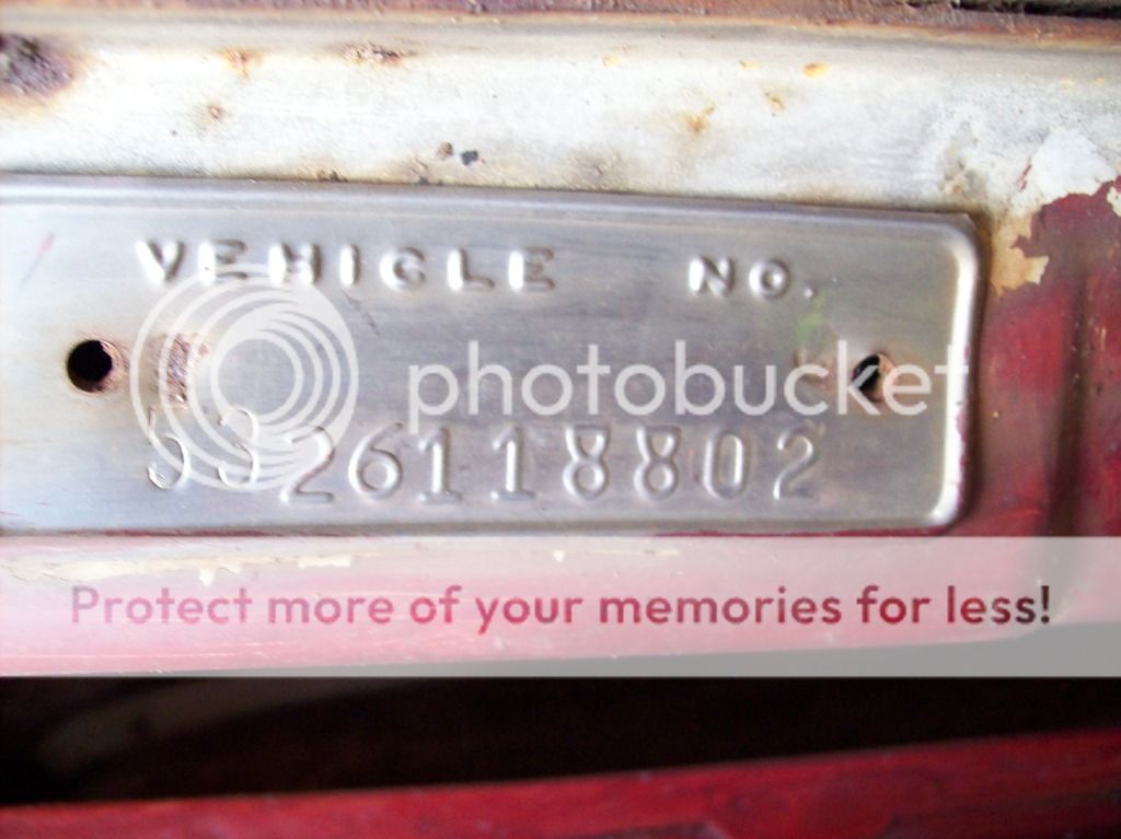

okay heres the pic of the vin tag too to figure out the starting point.
TY for the help.
i think its the original tag as the car was white and does have all red interior,including some odd rubber door trim with red cloth?
