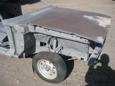

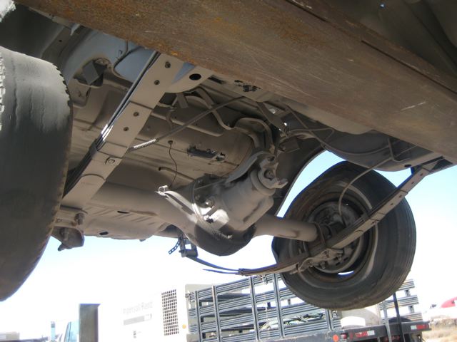

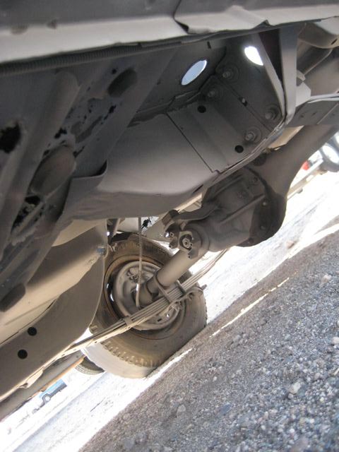

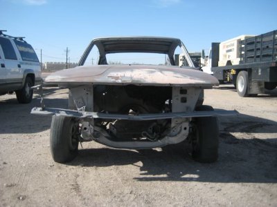

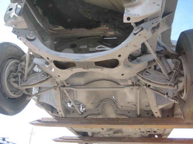

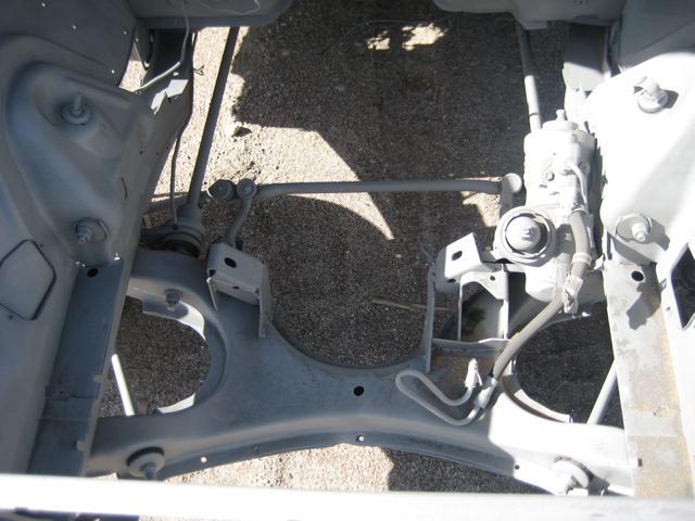

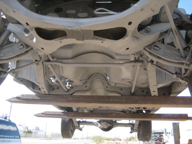

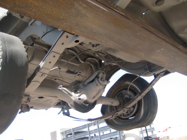

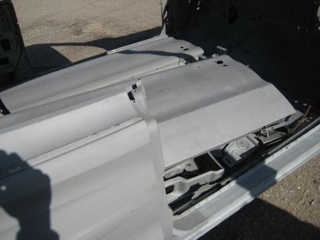

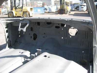

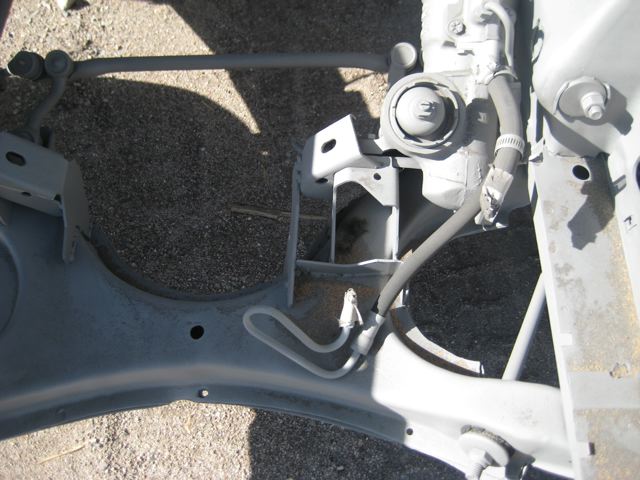

Here she is from the very bottom. With each passing stage I am more and more exited to be bringing this car back from the grave.

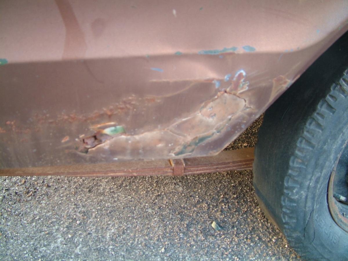

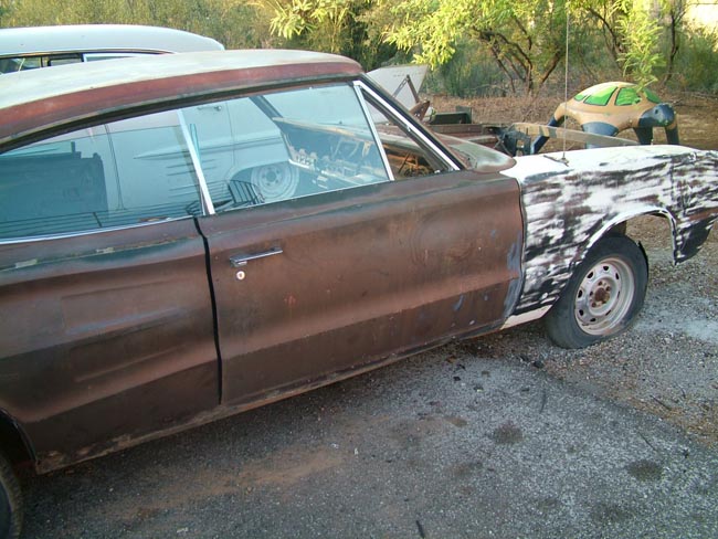

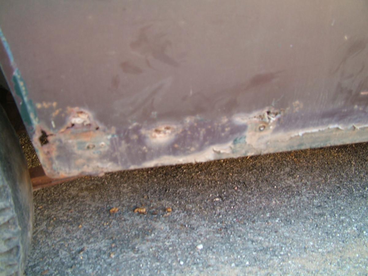

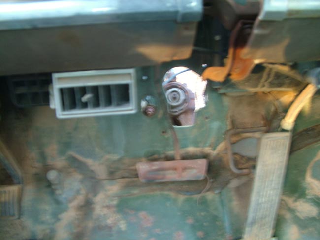

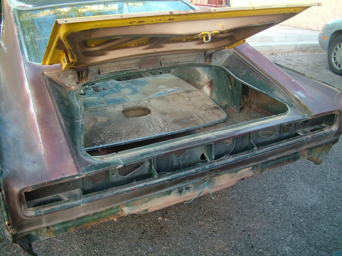

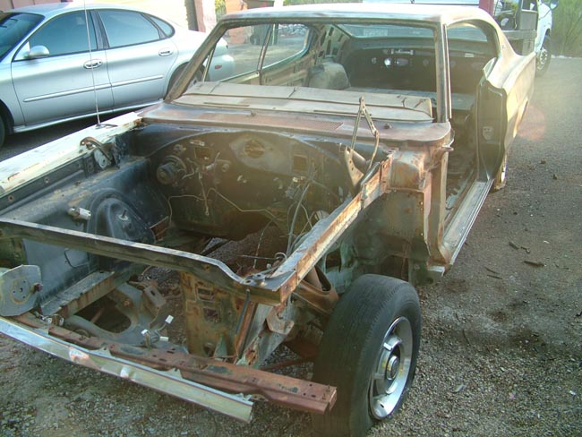

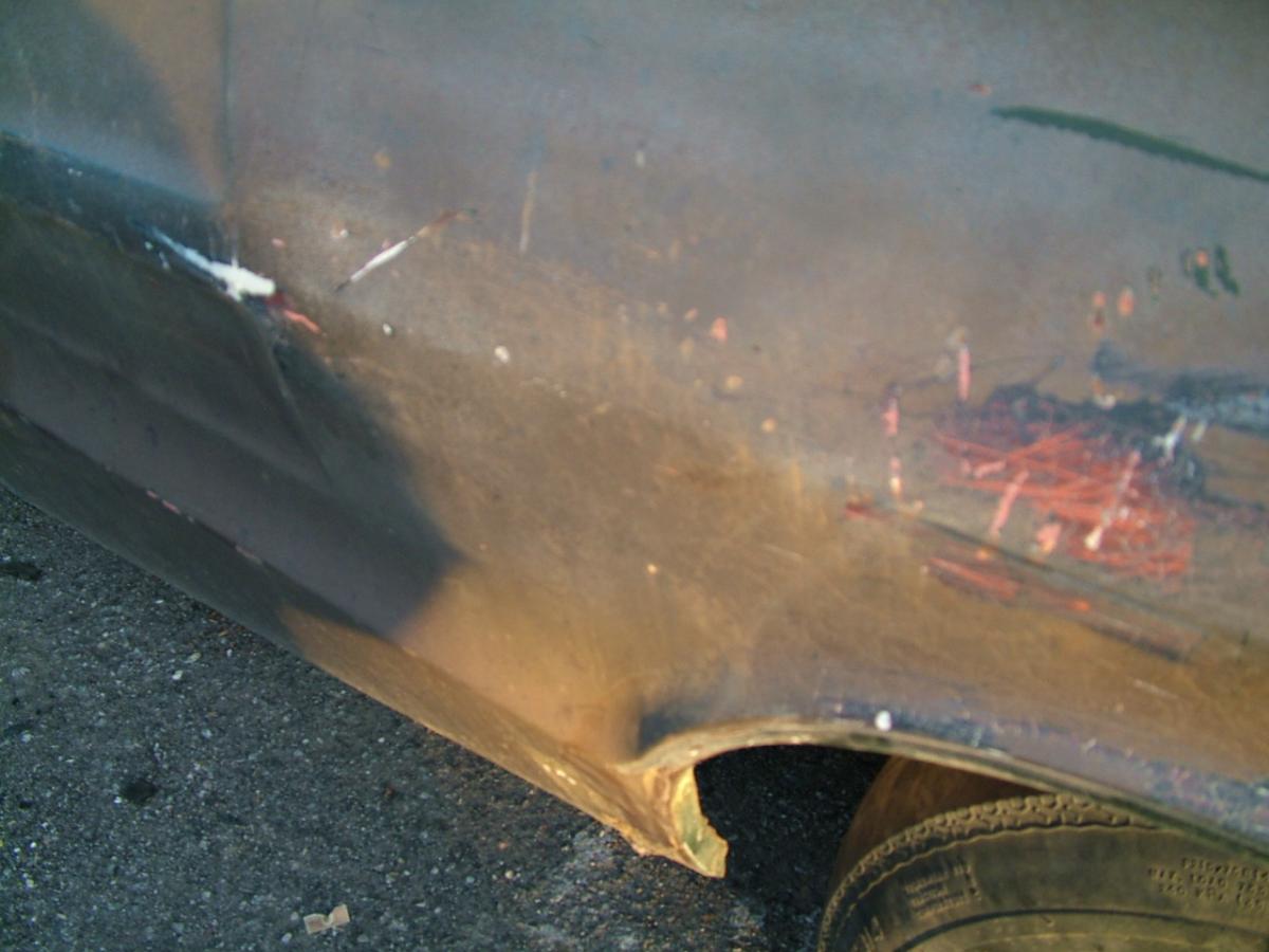

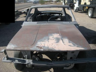

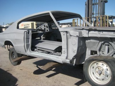

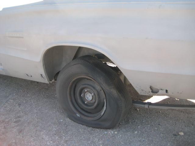

The Photos here depict her as I found her:
Its not that bad really. LOL.

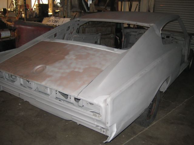

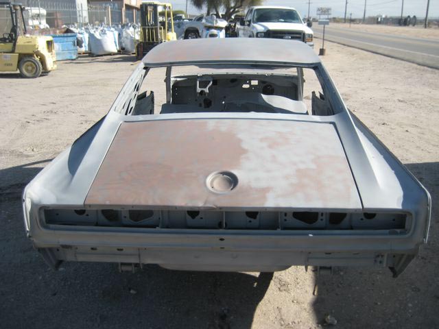

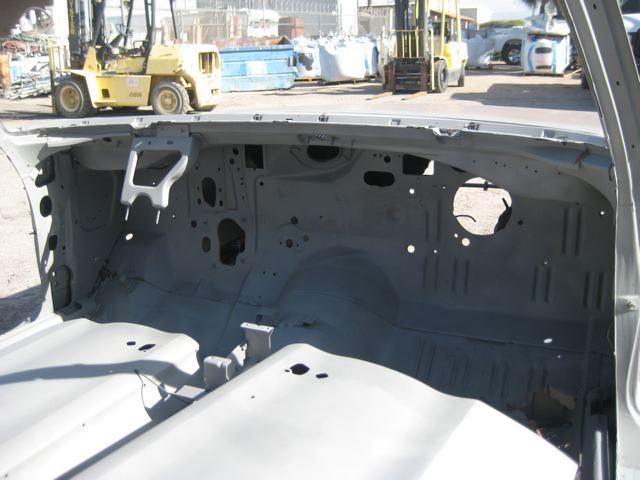

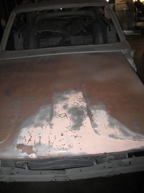

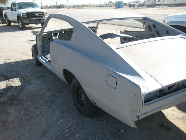

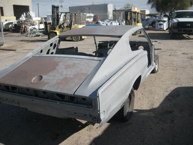

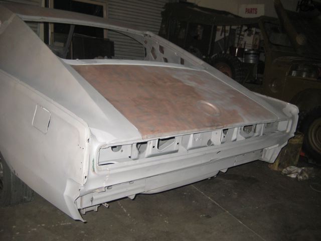

I spent about a year or so collecting things like a better hood and a door and a fender etc to complete the body. Then I recently sent her off to the sand blaster for a strip.

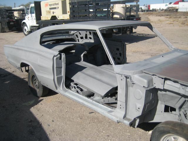

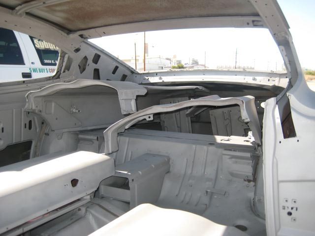

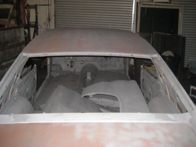

Now she is in bare metal and today I will be blowing out all the sand and putting it into a black zinc rust inhibitor coat.
So as you can see it is ready for body work.

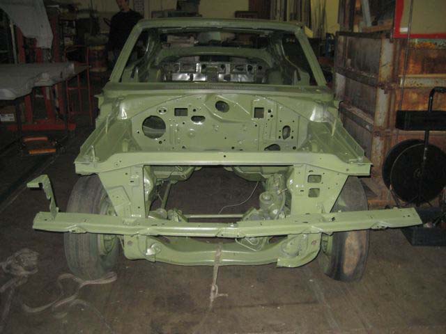

New years update:

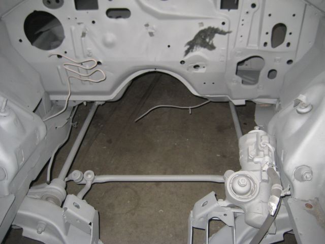

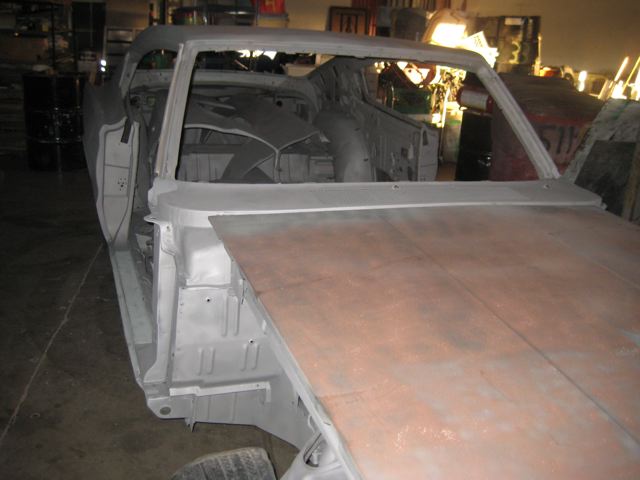

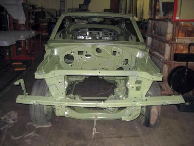

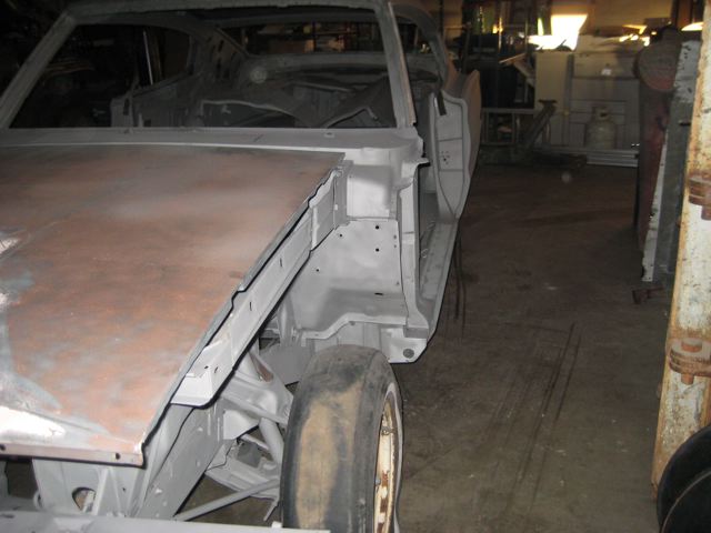

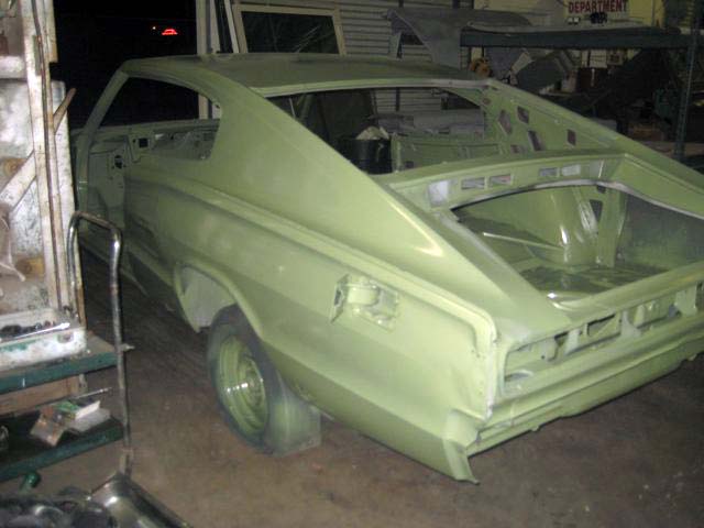

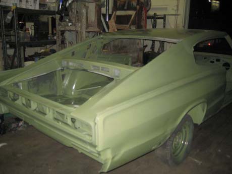

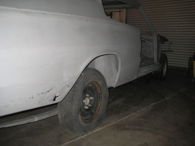

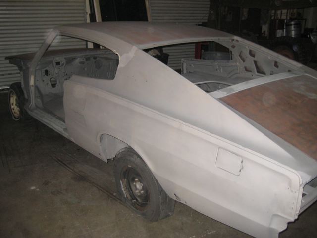

I just (finally) put the car into 2580CR to keep the bare metal from rusting.
The weather was not favorable for the last few days, but since I could keep it in my warehouse for the time it was bare it did not rust.
Here is what I learned painting at this level for the first time:
1. get good advice. Johnny at Hi Speed in Tucson turned me onto this 2580CR from DUPONT. Finish Masters was effing totally clueless and were trying to sell me a self etching primer that has to be primed after thus doubling my costs. Note to self, never listen to the people at the paint supply center in this town. When I finally got on the horn with Johnny, the Finish Masters people were saying that that was the best thing to do even though they never even mentioned it for the 30 minutes I was debating the clerk about why I should not have to use self etch and prime this early just to protect bare metal.
They wanted me to self etch then prime, then do body work and re-sand and then do it again before painting.
If you go to bare metal, get 2580CR to protect your metal while doing body work. It requires about 1 gal to do the entire car and a 2 to 1 reducer. Costs about $400 total retail.
2. Don't buy a Kobalt HLVP from Lowes. Its great until you start working sideways or upside down and paint starts to run all over your clothes, the ground, your hair and all over itself. If you never turn the gun to the side use this. Otherwise, steer clear. I will be returning this tomorrow.
3. Get a rotisserie. I put this car up in the air on a forklift. This is a bad idea all around. Not only must you trust your forklift with your life, its a pain to paint upside down. Especially with a crappy Kobalt sprayer. I have been trying to avoid the expense, but I would not go further on this car without a rotisserie.
The main flaw here was that the lid was cheap and never got a good seal. The gun is metal and the lid is plastic. Bad idea.

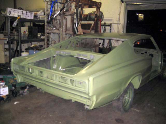

4. Test your painting skills on something other than your car. I started painting the left quarter and got a 4 ft run on the first pass. I learn very fast. Don't do that. By the next panel I was doing at least 98% good work and only ran 2 small spots after which I think is not too bad for a first timer under these conditions. I will sand these out later.
I also missed a few spots due to my next problem.
5. Don't start late in the day without proper indoor lighting. I did this job outside and half way through I lost light. That caused my second run and then I finished half the car with a flashlight. Not ideal, but I finished.
The couple missed spots I will shoot when I do the loose body parts I have racked. Hopefully I can do these with a better sprayer.

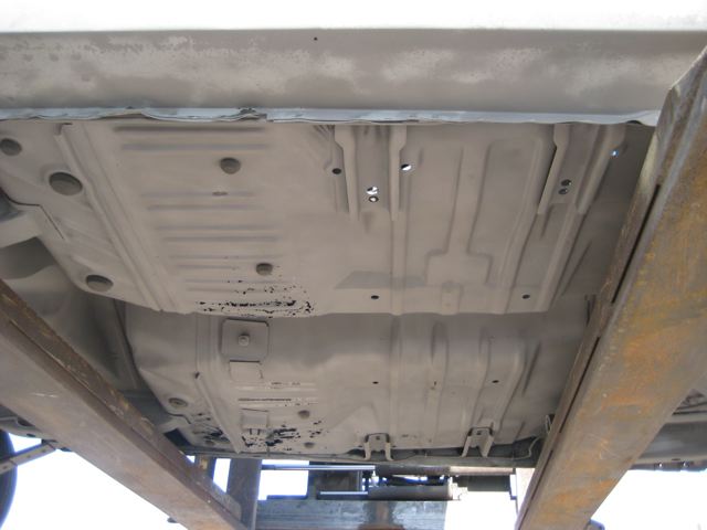

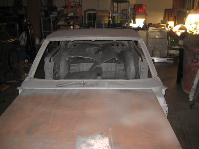

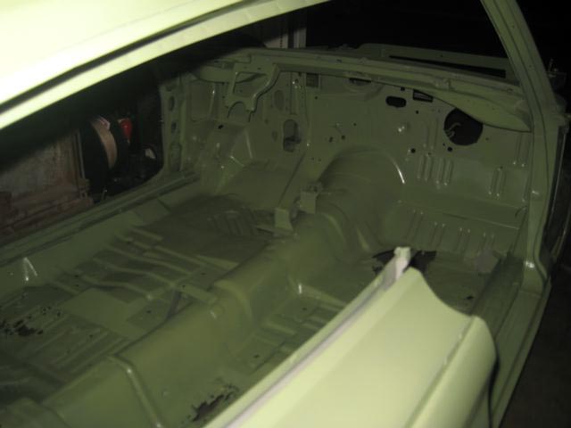

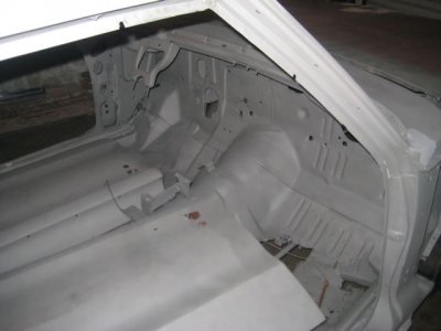

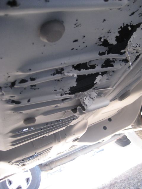

Here are the results so far:
6. If you are not using a rotisserie, you have to take off your shoes when doing the inside of the car if you want to keep it clean.

I have a pint of por15 on hand in case rust starts to appear on the doors, hood, fenders and deck lid in the meantime. My inside roof is seriously surface rusted and the blaster did not want to deal with that due to risk of warpage so now my next step is to get into the roof with a sponge full of por15 and see what transpires.
