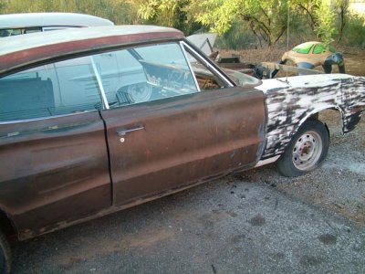

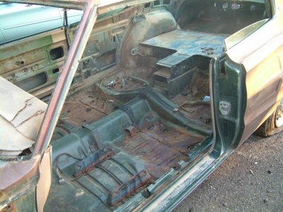

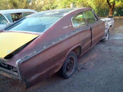

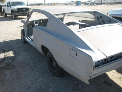

This will be my ground up restoration page for me 1966 Charger project. I bought it for $800. It was a very incomplete AZ car. No numbers match, no engine and no hope.
I stripped her to the body and sent her off to blasting. I am about to put her into a zinc black paint to inhibit rust while we do the body work.
In the meantime I have a 440 ready to rock n' roll for her with a mild street build at just under 500hp, aluminum Edlebrock heads and sweet as molasses.
My goal for this car is to do a mild resto mod. Since it has no hope of being an original numbers matching car, I though I would go this route.
The paint will be a single stage black. The entire car will have a mild pirate theme and be a complete blacked out car.

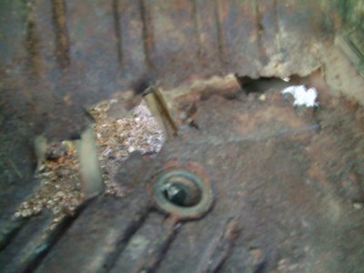

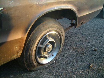

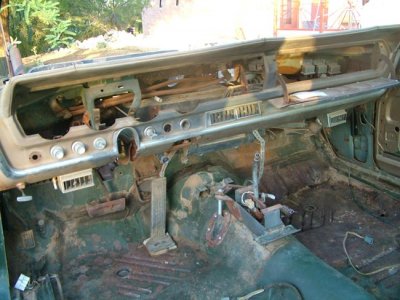

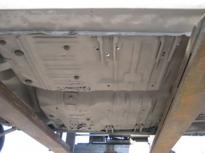

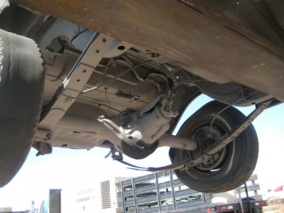

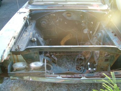

Here she is from the very bottom. With each passing stage I am more and more exited to be bringing this car back from the grave.

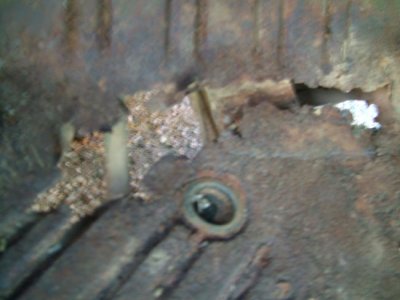

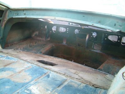

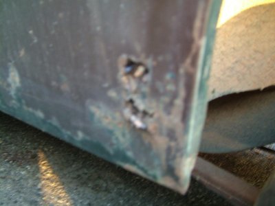

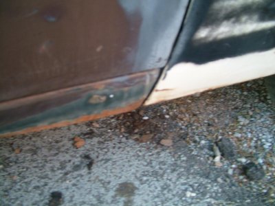

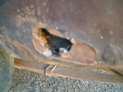

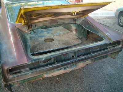

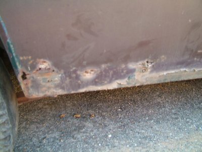

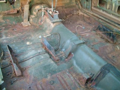

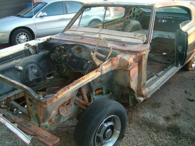

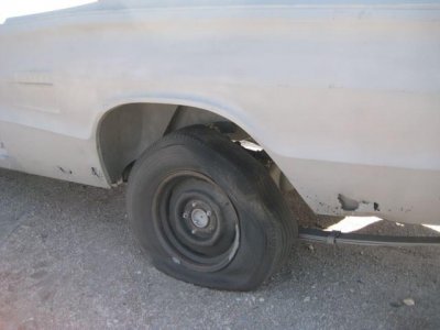

The Photos here depict her as I found her:
Its not that bad really. LOL.

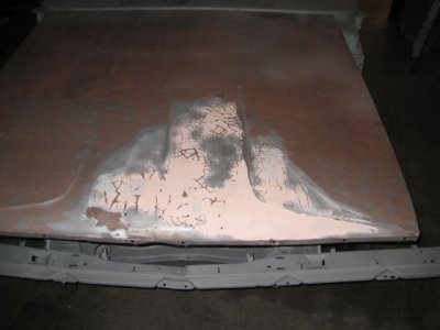

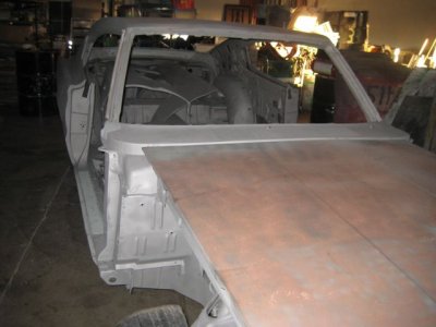

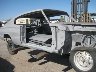

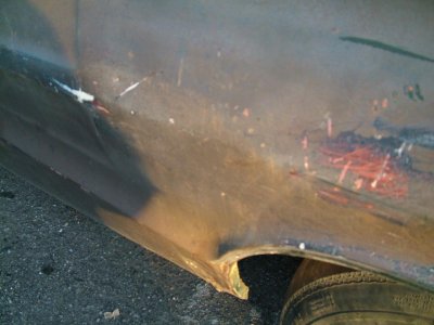

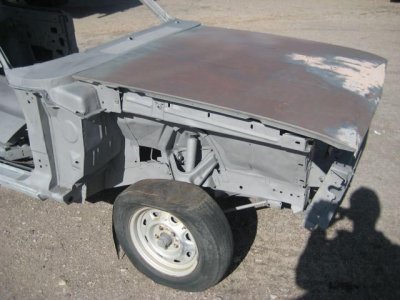

I spent about a year or so collecting things like a better hood and a door and a fender etc to complete the body. Then I recently sent her off to the sand blaster for a strip.

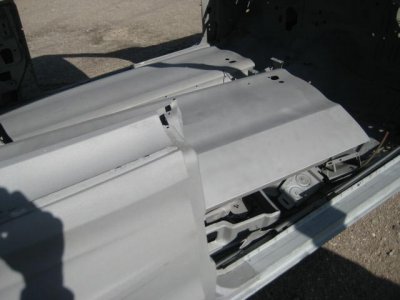

Now she is in bare metal and today I will be blowing out all the sand and putting it into a black zinc rust inhibitor coat.
So as you can see it is ready for body work.

Just a note, why is there no such thing as used 14 inch tires anymore?
I have to drag this babe around on flats.

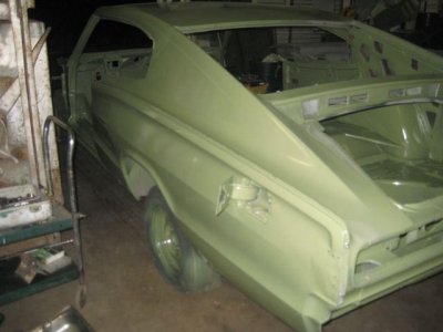

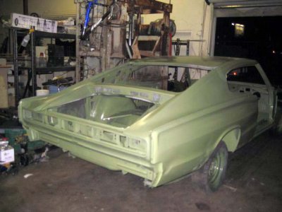

I just (finally) put the car into 2580CR to keep the bare metal from rusting.
The weather was not favorable for the last few days, but since I could keep it in my warehouse for the time it was bare it did not rust.
Here is what I learned painting at this level for the first time:
1. get good advice. Johnny at Hi Speed in Tucson turned me onto this 2580CR from DUPONT. Finish Masters was effing totally clueless and were trying to sell me a self etching primer that has to be primed after thus doubling my costs. Note to self, never listen to the people at the paint supply center in this town. When I finally got on the horn with Johnny, the Finish Masters people were saying that that was the best thing to do even though they never even mentioned it for the 30 minutes I was debating the clerk about why I should not have to use self etch and prime this early just to protect bare metal.
They wanted me to self etch then prime, then do body work and re-sand and then do it again before painting.
If you go to bare metal, get 2580CR to protect your metal while doing body work. It requires about 1 gal to do the entire car and a 2 to 1 reducer. Costs about $400 total retail.
2. Don't buy a Kobalt HLVP from Lowes. Its great until you start working sideways or upside down and paint starts to run all over your clothes, the ground, your hair and all over itself. If you never turn the gun to the side use this. Otherwise, steer clear. I will be returning this tomorrow.
3. Get a rotisserie. I put this car up in the air on a forklift. This is a bad idea all around. Not only must you trust your forklift with your life, its a pain to paint upside down. Especially with a crappy Kobalt sprayer. I have been trying to avoid the expense, but I would not go further on this car without a rotisserie.
The main flaw here was that the lid was cheap and never got a good seal. The gun is metal and the lid is plastic. Bad idea.
4. Test your painting skills on something other than your car. I started painting the left quarter and got a 4 ft run on the first pass. I learn very fast. Don't do that. By the next panel I was doing at least 98% good work and only ran 2 small spots after which I think is not too bad for a first timer under these conditions. I will sand these out later.
I also missed a few spots due to my next problem.
5. Don't start late in the day without proper indoor lighting. I did this job outside and half way through I lost light. That caused my second run and then I finished half the car with a flashlight. Not ideal, but I finished.
The couple missed spots I will shoot when I do the loose body parts I have racked. Hopefully I can do these with a better sprayer.
Here are the results so far:
