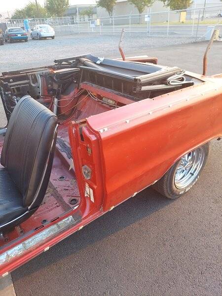

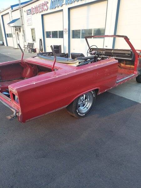

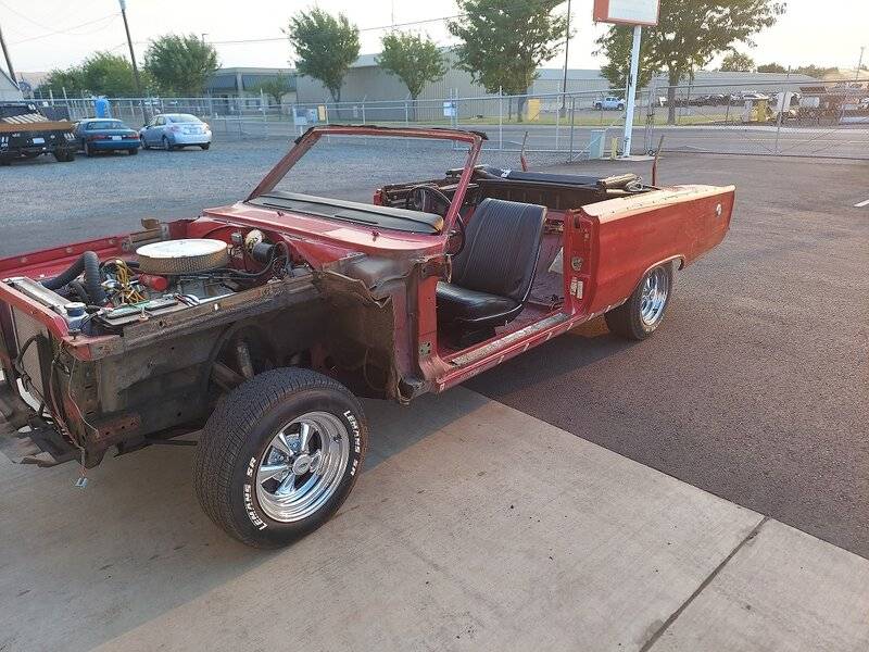

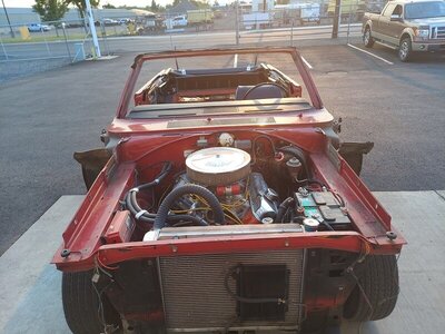

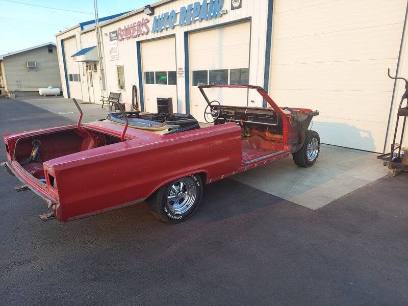

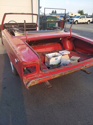

Im dumping a bunch of money into My 66 Satellite, Rust free. going to be pulling the engine and every thing on the fire wall, so its get painted with the rest of the car. Thanks

Lot of work removing trim! :thumbsup:Are you removing trim clips and buying new ones. The factory clips had little tabs so when you install the the trim they help prevent chipping the paint. Don't know if what's available now has those tabs. How's the fit on the driver's side corner near dutchman panel? Mine has at least a 3/8" gap, bet if I measured it could be a 1/2".

Yes have all new clips, that was fun finding them all, had bumpers straitened and Rechromed to the tune of 1800. Wow prices sure have climbed, all stainless has been polished. before we removed everything the gaps were all fine. Was hit once in the truck lid but i found a very nice trunk lid to replace it. I didn't want any bondo in it.
