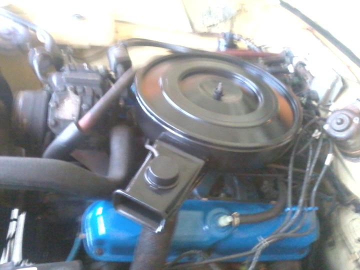

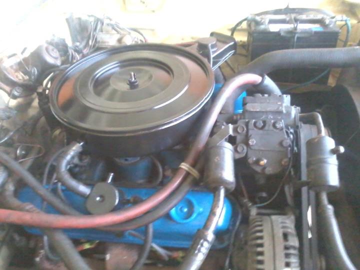

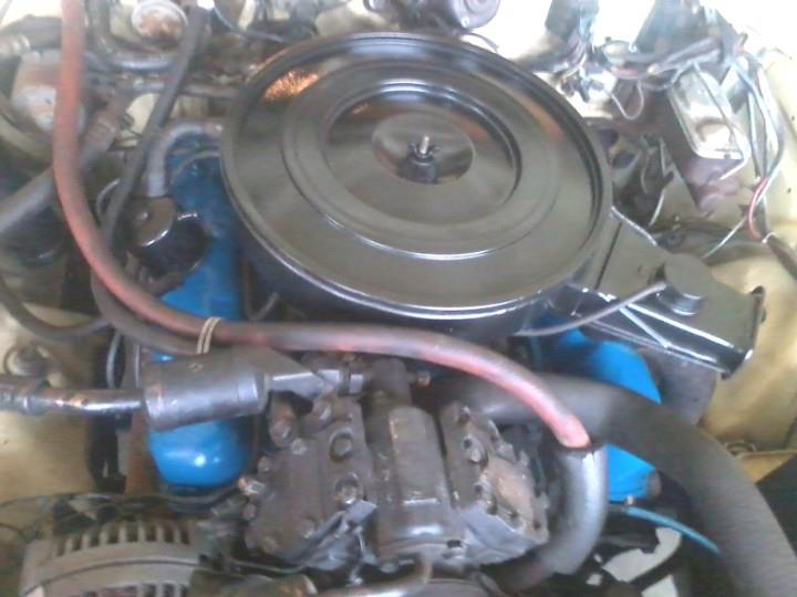

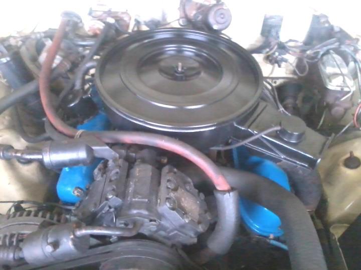

cleaned up engine bay...took a few things off and painted them the same color as they already were not best job but better than they were...gonna switch motors this spring so don't wanna do to much to it just wanna clean it up and make it look nice...wanted to make the A/C pump,lines and manifolds look better but aint sure best way to do it

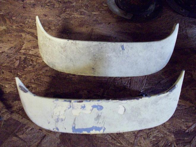

here ya go:
'70 road runner /GTX side scoops
$45 plus shipping near Philadelphia in New Jersey
Mark
midairmark2@aol.com
you go to moparts,main index,swap meet,B Body, '70 back for sael, near bottom of page 8

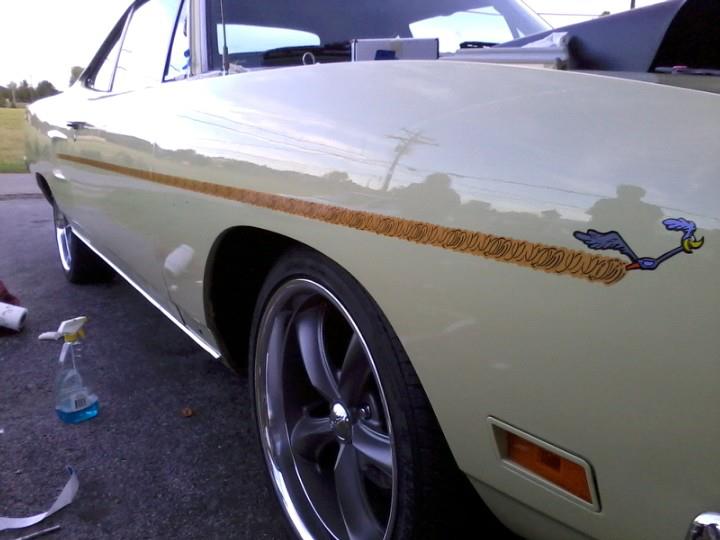

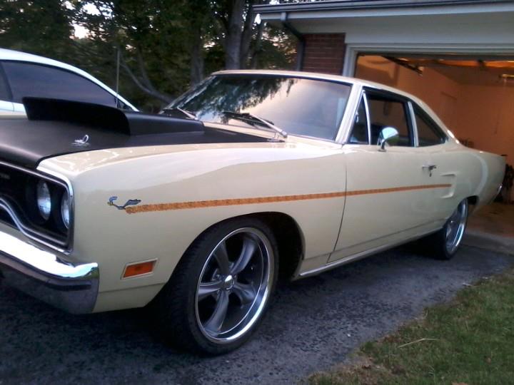

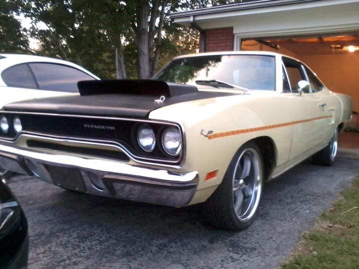

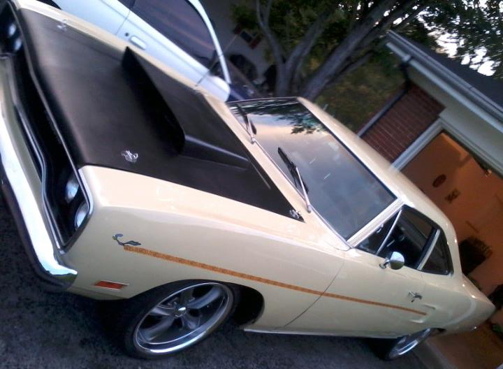

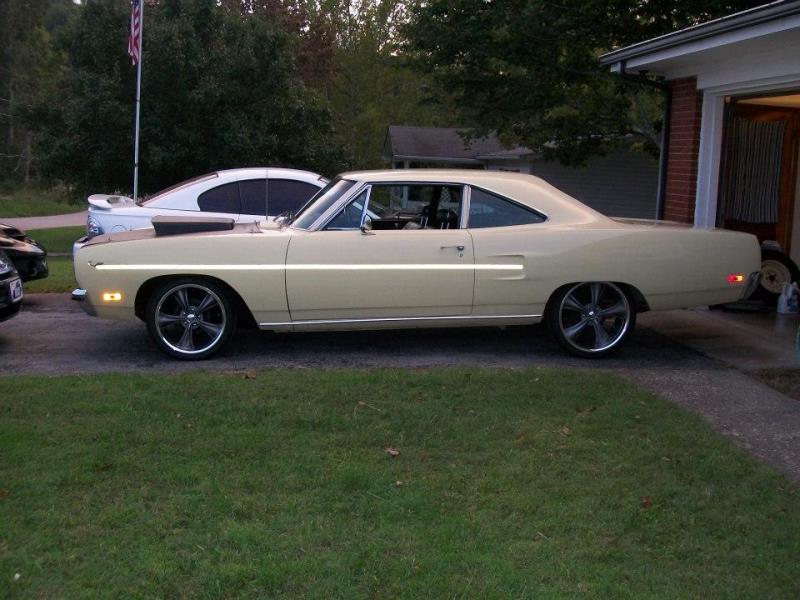

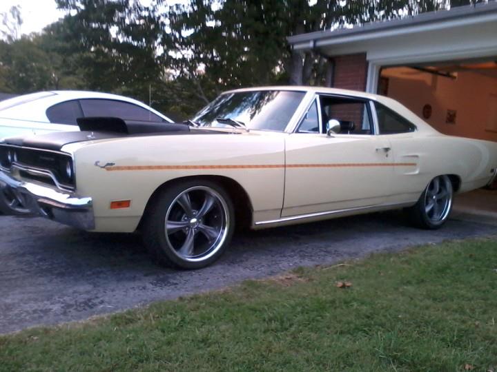

got my roadrunner stripes on...i used a laser level...its weird at some angles when u look its straight and then other angles it looks a lil high in front..i measured it all many times and used a laser level so its as good as i can get it...
looks great! so didya get the bezels?
the side scoop ones? no the guy had alot of ppl wanting they sold in a few hours...im still looking..got the RR stripe for rear decklid and getting new tips for mufflers
Fantastic looking man! Oh boy is the envy bug biting hard!! Enjoy it shes come a long way.. You really have a lot to be proud of here. :)

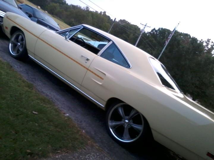

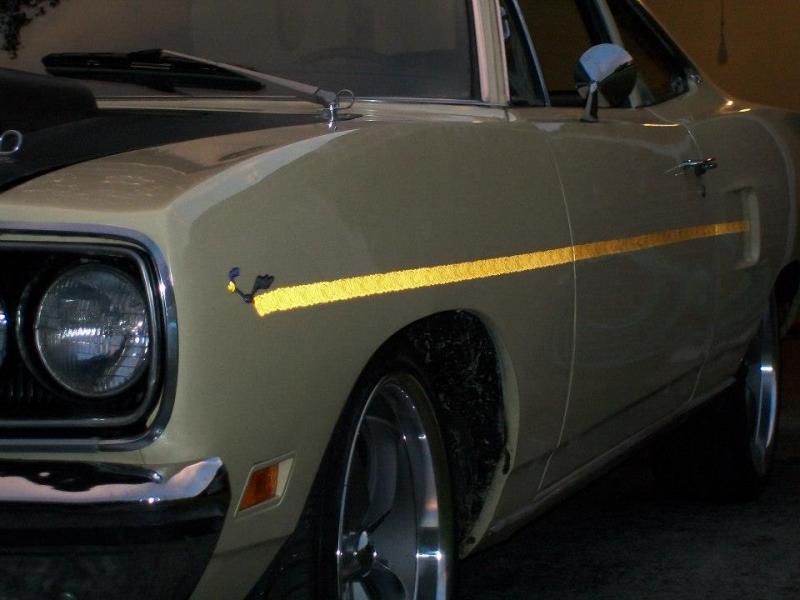

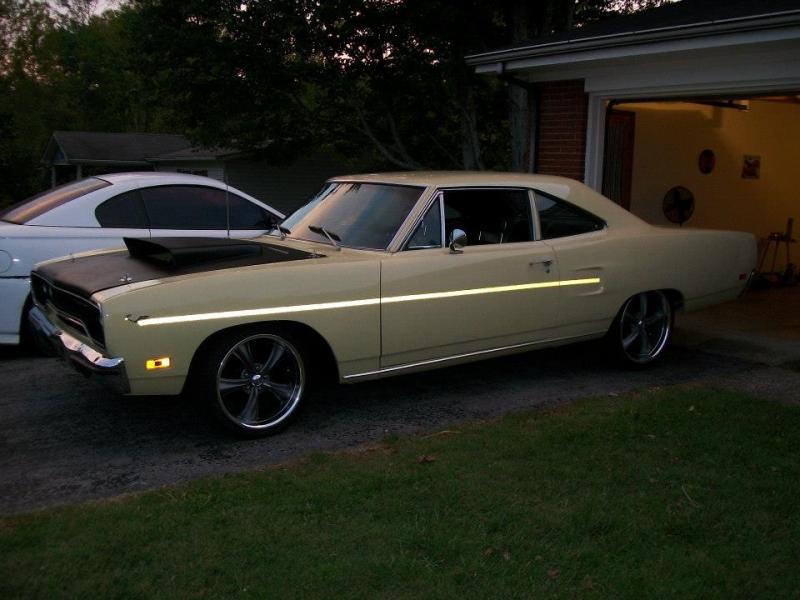

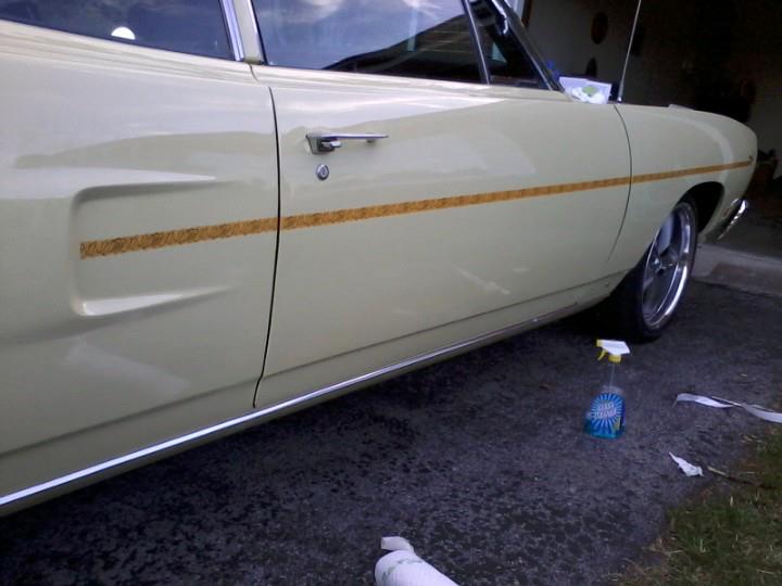

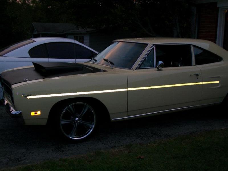

got the other side done saturday...had trouble getting a good line even with a laser...so me and my brother took measurements off the other side and copied it exactly..so both sides are identical..well worth the headache once i got done..the 3m stripes were well worth the money they went on easy and look awsome and seem very durable..still have to put the stripe on the trunk lid got all 3 in the kit..glad i got the reflective ones they look cool at night..took to show that evening and everyone loved it..
