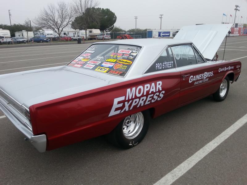

mike is this a track car or street car or Both
It is a "genuine" Pro-Street Build.
I will drive it only to 3-4 car shows a year (about 25 miles round trip each) and the rest is Drag Racing.
Trailering it to the track.
Most "so-called" Pro Street cars have a lot of hot rod parts, make smoky burn-outs, advertise tons of horsepower but are never "tested" at the dragser to prove their performance.
This car will be a true performance streetable car. It has current California License Plates. It is insured with Hagerty.
It has working headlites, tail lites, brake lites, turn signals and horn. I have taken out the windshield wipers and heater.
It has a full dashboard, glove box, etc. Regular glass windows that roll up and down.
It has a giant "BE-COOL" aftermarket radiator with twin fans on electric controlled thermostats. Earl's Trans Cooler
I just sent the converter back to Lenny at Ultimate in North Carolina and he is going to set up my converter off the dyno sheets that I supply to him. (He built the converter about 4 years ago).
Cal-Trak mono leaf rear springs with Cal Trak bars, Cal-Trak front 90/10's and Cal-Trak adjustable rears
Mickey Thompson Street ET Drag DOT 11.25 wide (28x13.50x15) slicks (non-radial), narrowed rear end and mini-tubbed, and Moroso 28" DS-2 Drag Special 4 ply front tires
My engine builde is going to bring the motor in at around 625HP and 600lbs Torque at 11.25 CR so I can race (and drive) with Pump Gas. At the drags I can run VP 100 Race Gas and get about 1/10 better ET, if I want.
If all goes well it should run around 10.70 and 125 or so plus then be able to drive it into the hamburger stand

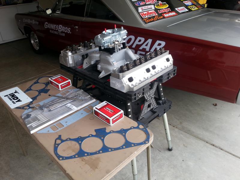

Mike your combo sounds very much like the 512 I'm getting ready to put in my 67. What heads and cam have you selected?
I have the INDY SEZ heads and INDY Valves, Retainers, Viton Seal and Locks along with the INDY 9.75" long Pushrods.
He is going to use COMP Valve Springs.
My engine builder is having ENGLE CAMS custom grind a cam specifically for my motor, car, weight, etc, etc. It will be around 620" lift. Along with Solid Lifters supplied by ENGLE.
The motor will also have 440 Source 1.6" roller rockers.
I included a picture of the INDY HEADS, INDY DUAL PLANE INTAKE and MIGHTY DEMON 850CFM CARB.
