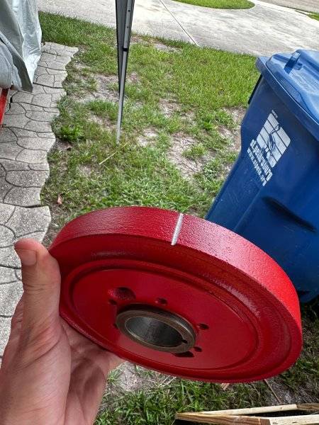

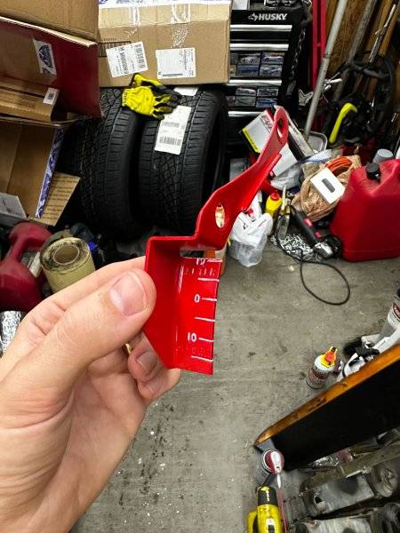

I have had some tins of One Shot paints for a while, and decided to apply some white to the timing indicator and the balancer. Even though the motor is timed from before disassembly, I have a feeling it may need a tweak now all the components are new and nice. Plus it just looks good having this done.

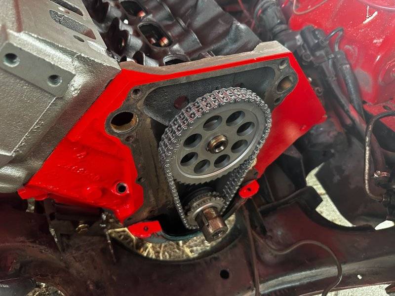

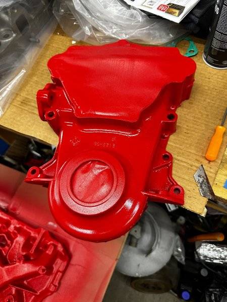

After pulling the old timing set, I thoroughly cleaned the block and painted the visible areas using the same method as the other components. I installed a new double roller timing set from Cloyes, as the old one had way too much slack in it. To the point that I am convinced it could likely have been the cause of the 3 bent pushrods. Pre lubed it, and go the fuel pump wobbly cup on too.

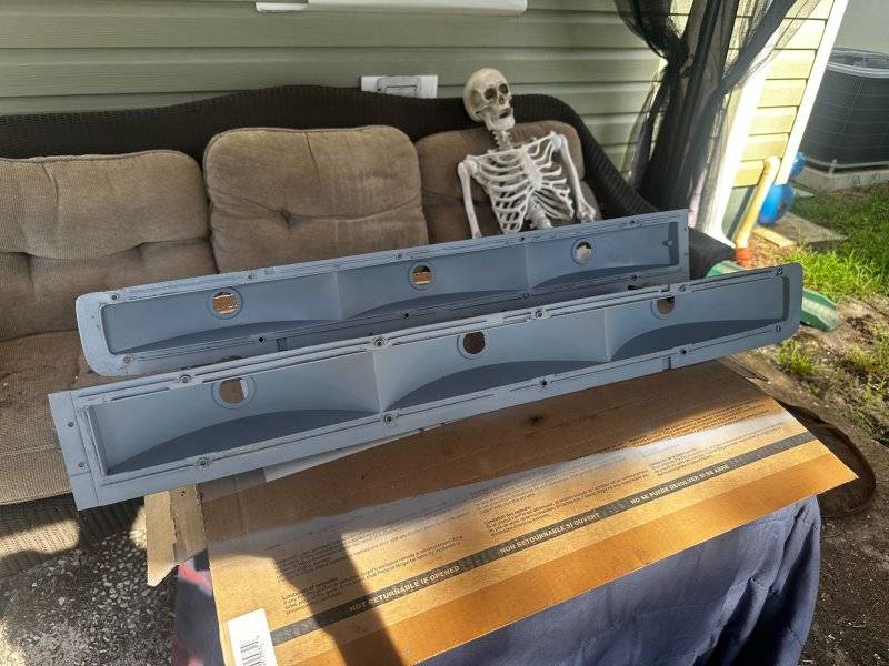

I completed the dissembly of the tail light housing and trims. 4 of the screws were SEVERELY rusted and no removal effort I made worked. Even drilling them out was a battle, so I ended up slowly and carefully grinding the heads off of them. Managed to do it with almost no contact on the tail light housings, so I am pretty pleased with the result!
My housings are suffering from some flaking of the reflective material inside. Like every other part I have touched so far, I will be refinishing them. I have a reflective silver paint that I will be applying to make sure they function properly and the light is nice and uniform.

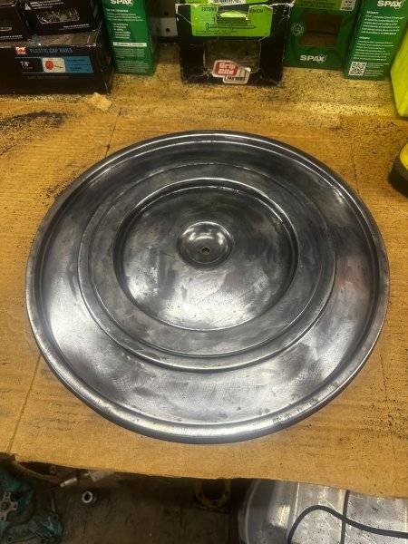

I also received the factory air cleaner and will be refinishing that soon as well. Anyone got a recommendation for a filter to drop in this thing? Came off of a ’66 Coronet. This is my first time working with this style of air cleaner. My ’59 had simple frog mouth scoops and I made filter inserts for them.

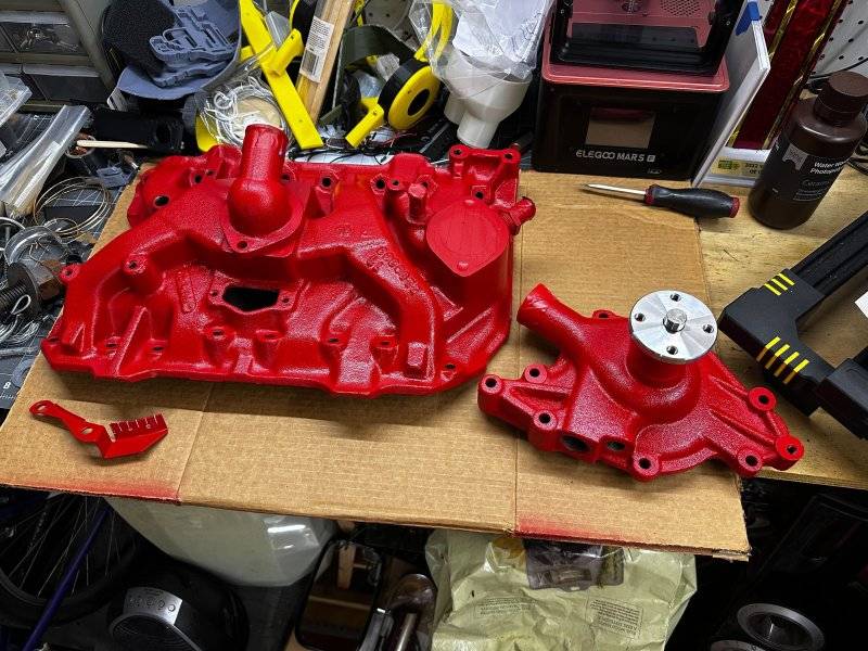

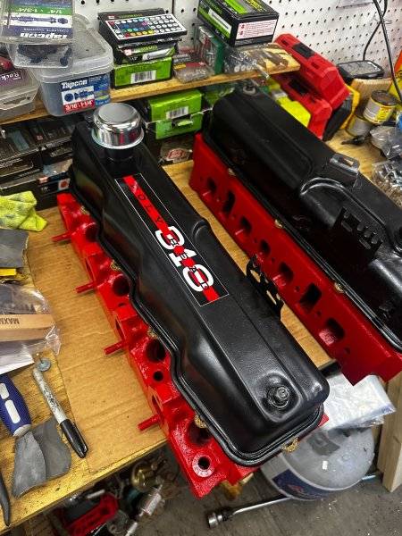

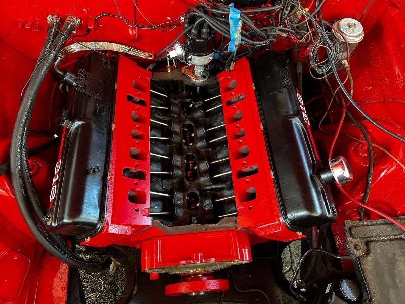

I got the last of the engine components refinished, most notably the cylinder heads. I also picked up a pair of the "318 Poly" decals as I like the way they looked on a few other cars I saw in person. Next weekend is going to be the reassembly of the engine and I am VERY excited!

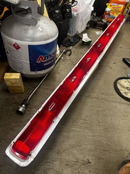

I spent a lot of time refinishing the taillight assembly too. The reflective coating was flaking off from inside the buckets, so I spent a while removing the flakes then sanding everything to level out and smooth the surface. After getting them as smooth as possible I gave them a nice even coat of primer.
You can see me in the background of that picture after 10 hours in 98 degree FL weather. I have seen the debate on white versus silver for the inside of the buckets, and decided I liked the idea of more of a "mirrored" finish since that is what the factory had. I have worked with "chrome" spray paints before and been nothing but disappointed, but I used a Rustoleum product and was actually pleasantly surprised at how similar the finish was to the original!

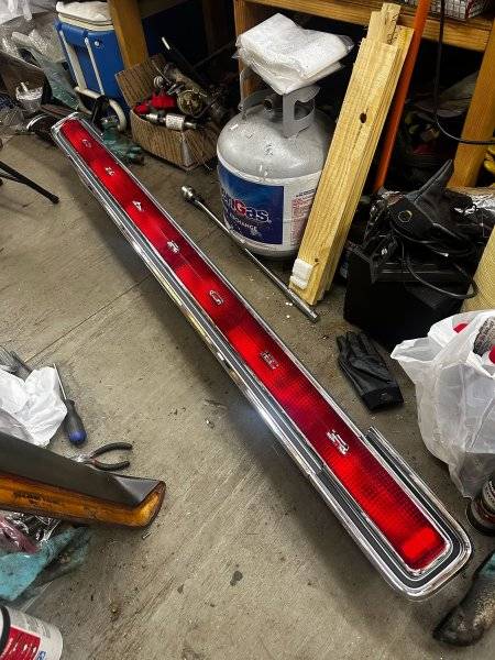

I picked up new stainless 8-32 screws for the trims, as the PO had secured the old surrounds on with aggressive and incorrectly threaded rusty ones. I also added the new Detroit Muscle gaskets for the lenses which fit perfectly. At first I was unsure about them being white, but then when I saw where they sat I figured it made sense rather than having a black line around the lens.
The lenses fit nicely, and from my reminded me of the huge improvement that the new ones made on the '59. I just wish they were the same price! Try $60 instead of $600... I am sure everyone on here already knows it but that Mopar Tax is real haha.
The trims were surprisingly fiddly to get installed, but I got there in the end. I was being extremely careful not to mar the new lenses or chrome. lots of tweaking and adjustment later I got everything lined up relatively well. I did a quick test fit on the car and am pretty happy with the result. Have to pull it one more time to tweak a couple more things, including adjusting the trunk lid, but I am overall quite pleased with the improvement. The taillight now looks as good as the new rear emblem!

Big progress over the weekend, albeit thwarted by half a day of rain on Sunday. Got the surfaces cleaned and prepped, and dropped the new gaskets in place after a final inspection of everything that was about to be sealed up.

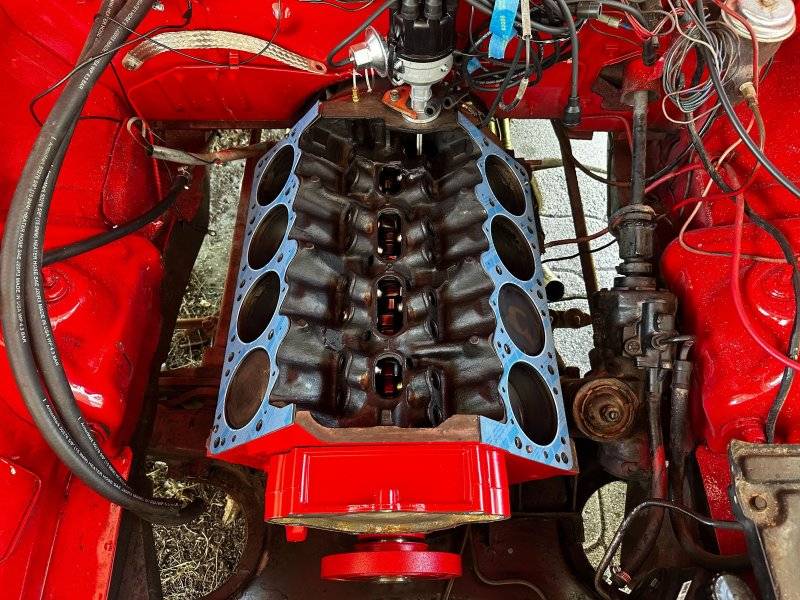

A friend of mine came over and helped me lug the heads back on. I am genuinely thankful to the person who wrote the post explaining about how you can slide the rockers to the side to insert the pushrods. I was genuinely baffled until I came across that details, and it made things SO MUCH EASIER! With those in place, I got the heads torqued down to spec thanks to the info on poly318.com and they are there to stay. And yes, I used sealant on the threads!!
I pre-lubricated all of the contact points in the valvetrain, then got everything covered up to keep out any dust and debris. I can't tell you how nice it is to have this engine in the correct color, and with 16 straight pushrods! I still need to go back and adjust the valves, but that will come after I get the front end assembled.

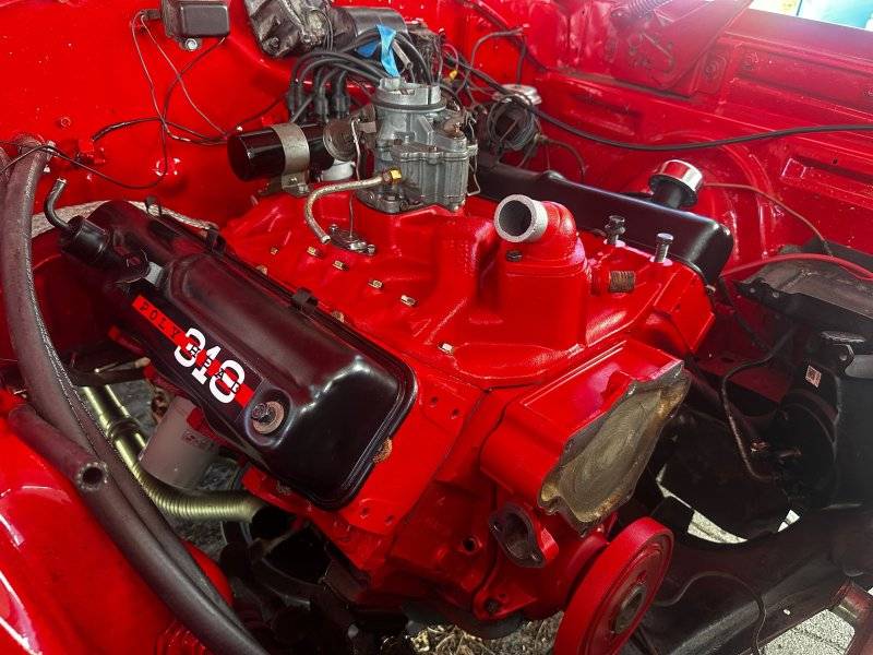

After prepping the surfaces, on the block and heads, I dropped on the new gaskets and used some RTV in the appropriate places, then dropped the intake manifold down onto everything. Got it cranked down to spec with the new hardware, since the old bolts were extremely crusty. I went for Grade 8 with stainless washers to prevent the heads from tearing up the paint. I was not sure which of these bolts needed sealant, so I played it safe and used it on all of them.

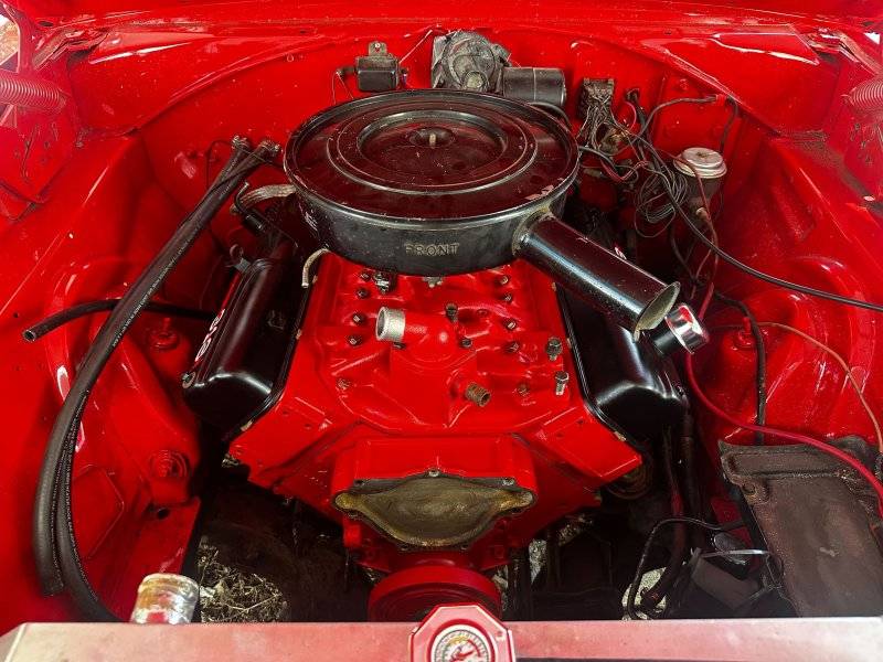

I got the new thermostat and housing installed, and the carb was already rebuilt from before the teardown so that just dropped right on as it is. I am thinking I may pull the coil back off and paint that bracket black, but we will see how I do on time.

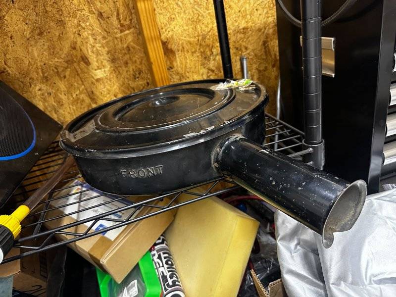

I dropped on the factory style air cleaner that I picked up on here to keep dust and debris out of the carb, but quickly my OCD kicked in and I pulled it back off to start stripping it back for paint so it can look as fresh as everything else on the engine. Turns out I had a K&N filter on the shelf that dropped right into this air cleaner, so that made things easy!
I still have a couple more hours to put into stripping the rest of the air cleaner and getting it painted up, but I can see the finish line now! Next weekend will be the front end assembly and we should be close to ready for a first start after that.

- Completed the final install of the fully refurbished tail light assembly

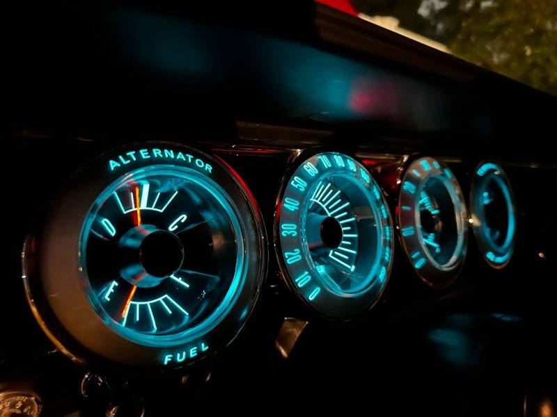

I mentioned in the previous post that I had Todd's Restorations redo my gauges, head unit, and headlight motors. Those are now back in my possession, installed, and working beautifully. Nice to finally be able to drive the car at night!

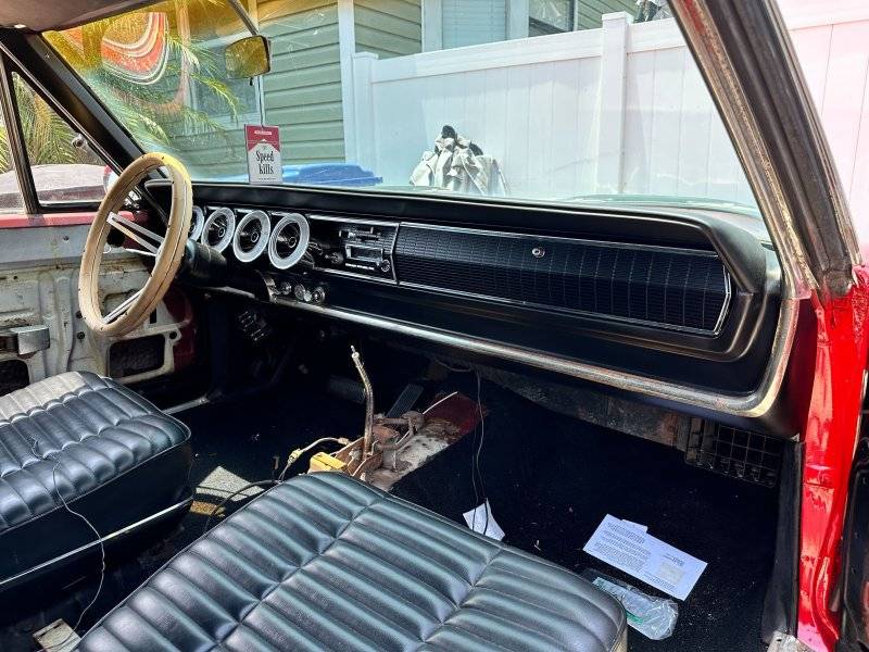

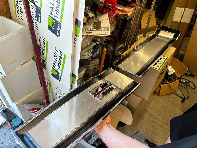

I have also now nearly finished the quick refurb on the whole dash and center console. I am not aiming for perfect, but I had to clean about 10 lbs of dirt and other crap out of there. After peeling the weird veneer off of the center console as well, I polished and repainted everything. I also used a brushed aluminum vinyl to refinish the "ski slope", not bad for $8! I will eventually buy the proper repro ones, but only after I complete the 4 speed swap.

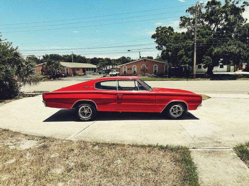

I just bought a set of Chrome Torque Thrust II's for mine. I went with 15" rims. Im going for that 70s look anyways.
Nice! I would have sold you mine but I still need em for a while haha. The bill from the engine builder working on the 440 is definitely going to max out the budget so I can't jump and get the Series 63s just yet.

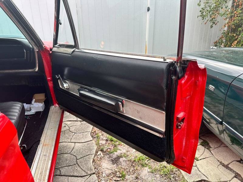

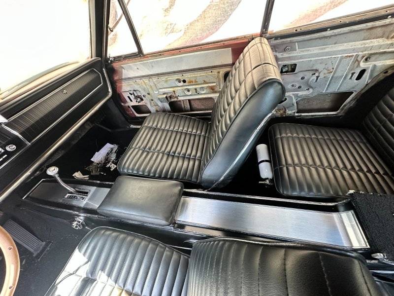

I decided to clean and install the door panels as-is. They are tired, but I can live with that. Originally I was going to have them all redone before putting them back in the car, but that budget also got absorbed into the 440 build. It is nice having them in place, the car feels a lot more "complete" when I am driving it around now.

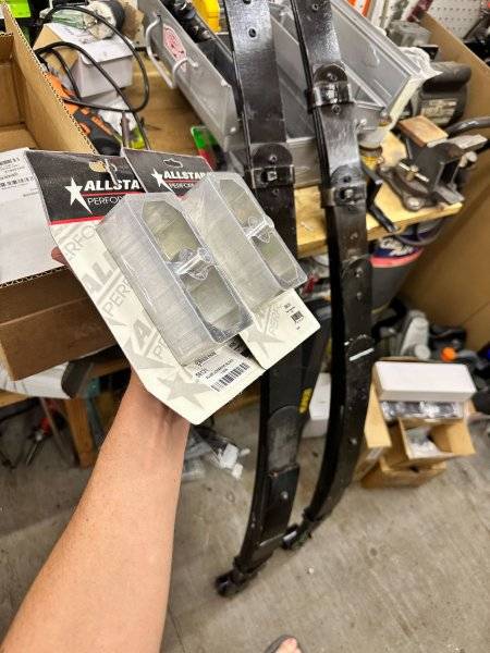

I picked up some lowering blocks for when I eventually do get the steelies for the car, but mostly because Mancini Racing had a great price on the kit and it cost the same as just buying new U-bolts would have. I am not optimistic that the old ones will come off without a reciprocating saw.

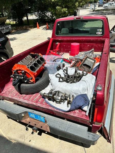

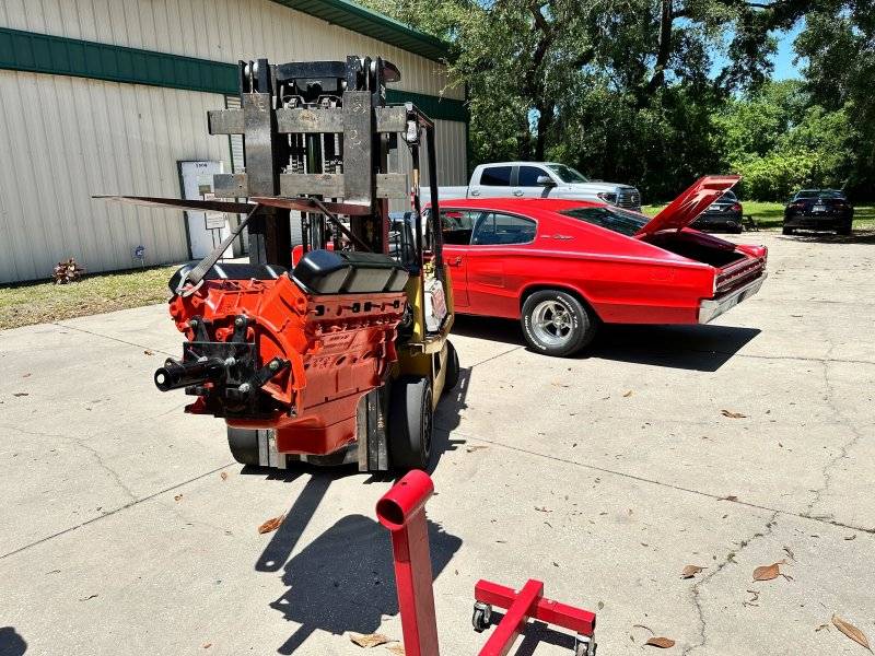

So the secret of movie magic is going to be released a bit here haha. That 440 was purchased from the same guy I got the car from. He told me it had come from a running mud-truck, but he replaced the heads with 906s because he found a crack in the corner of the original ones. The gearbox was just sitting under a bench in his shop, so I picked that up too.
The TV show did successfully finish rebuilding the 4 speed. It was a pain for them, so the last few steps took a while. They tore the 440 down and inspected but that was it. The full rebuild of the motor would truthfully be too much work/cost for them to do all by themselves, but I do want to continue working with them for at least one if not two more episodes. Because of that, I picked up the disassembled motor and took it to a near by engine shop that does lots of performance builds. It's all on my dime, but will be a solid, running, ready to roll motor when I bring it back to them. Hoping maybe they will take on the actual swap and a few of the parts relevant to that procedure, but we will see.
