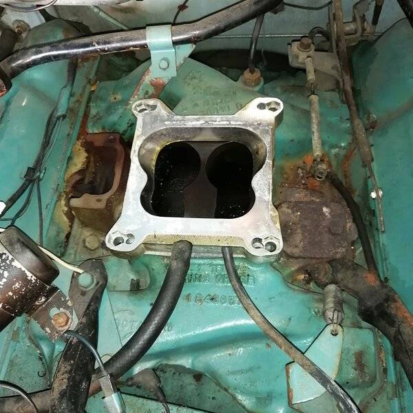

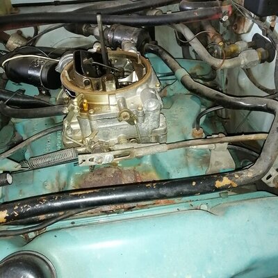

Started my updates with the carb and air cleaner. I knew it was an AFB carb on a thermoquad manifold with an adapter, but look what I found, it was upside down! I replaced the adapter with a stock thermoquad quarter inch fiber base gasket and a four hole aluminum plate sandwiched between two square bore gaskets. That got rid of my heat soak issues, and it runs pretty good now. I also adjusted the kickkdown and the trans is shifting much better now as well. I have a new intake and carb to install in the winter, and I will have to redo the throttle and kickdown linkage as they just bent the two barrel linkage.

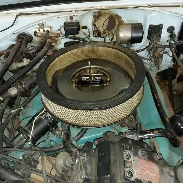

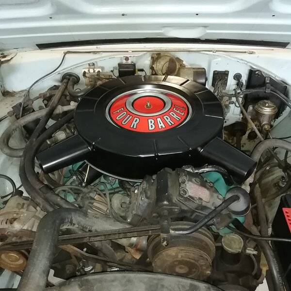

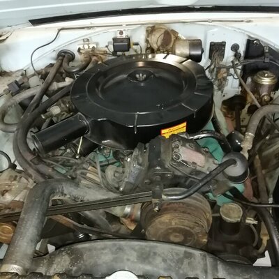

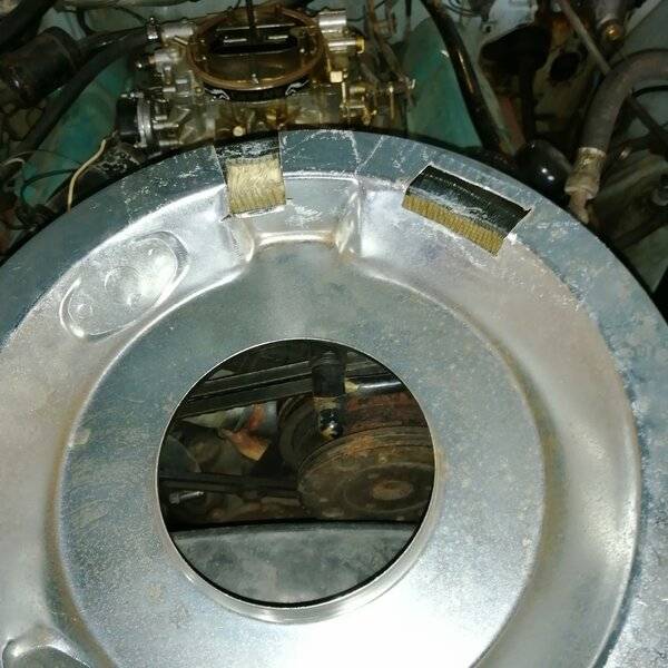

The air cleaner was another mess. Look at the hacked base plate they used with the stock two barrel top. Nice sharp edges right over the fuel hose. I got my restored air cleaner installed and it just fits on the drivers side between the two A/C lines. The car is a great cruiser, and I am loving driving it so far. Lots of other little details to finalize yet.
old air cleaner top.jpg old air cleaner base.jpg old air cleaner bottom.jpg new air cleaner.jpg

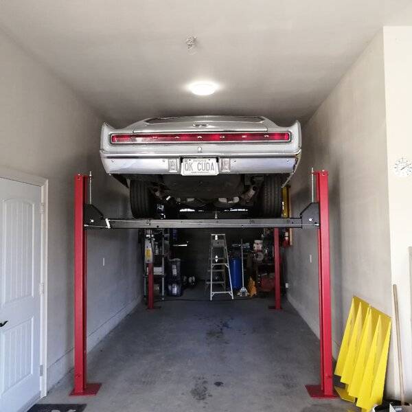

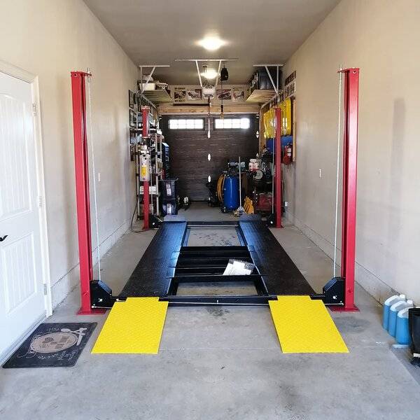

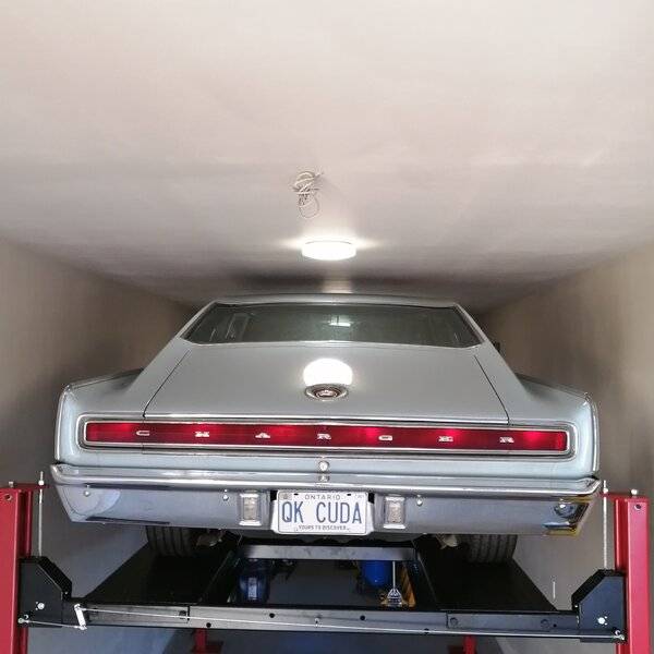

Got my new lift today, so I have lots of little projects for the winter. It is going to be so nice working underneath now.
What an improvement, makes the hobby way more enjoyable. I would like to have one too. Congratulations Dave, that's a nice man cave.
View attachment 1024831 View attachment 1024832
Awesome improvement to your garage, im jealous. You can store more cars in there, and work on the car from underneath WITHOUT a jack or jack stands. Man lifts are a beautiful thing and invention, wish we had one or 2 in our garage but sadly it is too small. Damn from that picture it looks like the roof of the car JUST touches the roof of the garage
