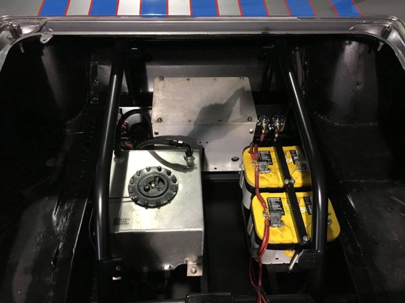

They are now set on FULL SOFT, setting #1 on the dial on the shock...I do not know if these single adjustable Cal Trac shocks are adjusting the "compression" Or "rebound"...all I know is that they are single adjustable.
Cal Trac TECHS say to set them on number 1 for a Trans Brake and that worked fine BEFORE I took out the 120 lbs. And that setting works fine AFTER I put 120lbs of ballast back into the trunk.
Is your advice to set them "stiffer" up the scale....like a 5 or 6 setting ? Again, I do not know if this is compression or rebound control.
You say your son has Cal Tracs. Does he have Cal Trac 9 way Shocks ? If so what setting does he have them on ?
