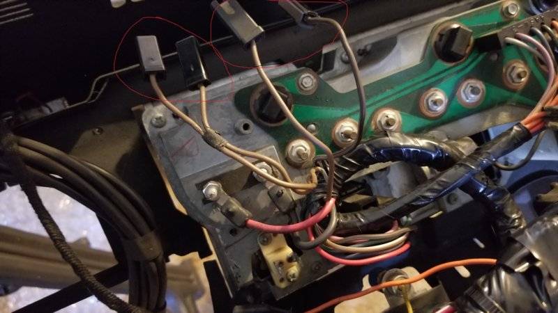

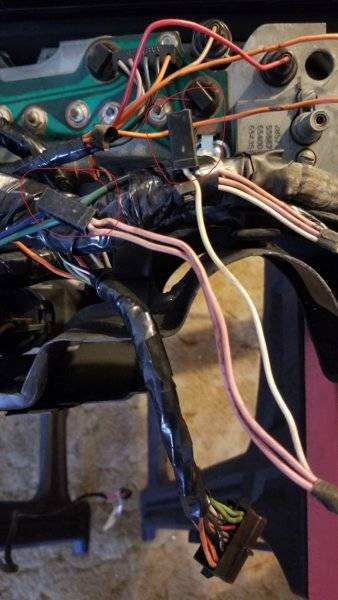

These dash harness plugs have got me stumped. I think I got most everything else thanks the the fsm but can't seem to remember where these go. Any ideas?

Im being told the pink and white are for the brake switch on the pedal assembly. Two tan tied together are for the pump button. Just leaves the two other brown ones.
68 charger rallye cluster a/c with automatic.
This is correct,
the white and pink wires are going to the brake swtich. The pink one to the back of the switch and the white to the front.

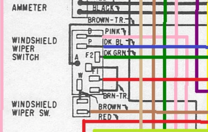

the brown wires that are taped together are for the windshield wiper water pump. One of them has a connection to the other brown cable. It is a link between the button for the water pump and the wiper switch. The other brown cable should be Triggered (white) and is also going to the wiper switch. Other end is the wiper motor.
The brown cable goes to the "W" labeld connection on the wiper switch and the brown triggered goes to the "A" labeled connetion on the wiper switch.
If you have 2 speed wiper motor there is one brown wire that doesn’t get hooked up iirc.
