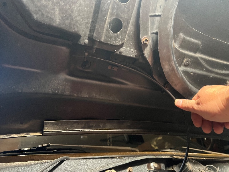

Hi All,
Hoping you can help point me in the right direction as to how the cable routes from the inside of the car to the control lever of the fresh air intake system. My car did not come with a cable (big surprise there) so wondering the proper way to route. And which sided it connects to. I presume it attaches to the passenger side lever? As the FSM says right hand side. And… if I route the cable to the left side, it will not properly secure into the cable stay. So it routes through the firewall and connects to the passenger side, correct?
Thanks very much for your ongoing support with this
Beautiful bucket of bolts that has been dumped into our lives,
Mikey

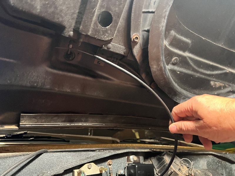

Dave!!! Thank you so much. That helps a ton. The cable seemed to be too short to connect to the driver side so I rerouted it to the passenger side. Waiting for the clips to arrive but I think that should do it. As far as routing the cable under the dash and through the firewall, do I just try to make the bends as smooth as possible?
Edit - Dave, so compared to your Bee, does my cable routing look somewhat correct? Coming from the FW, bending towards the driver's side, then curving back toward the lever?
Thanks,
Mikey

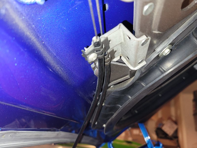

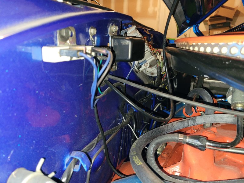

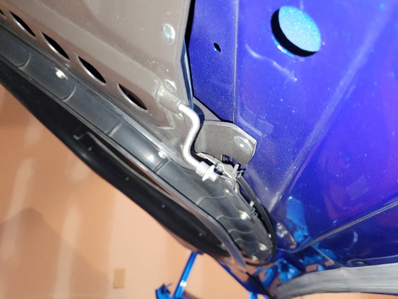

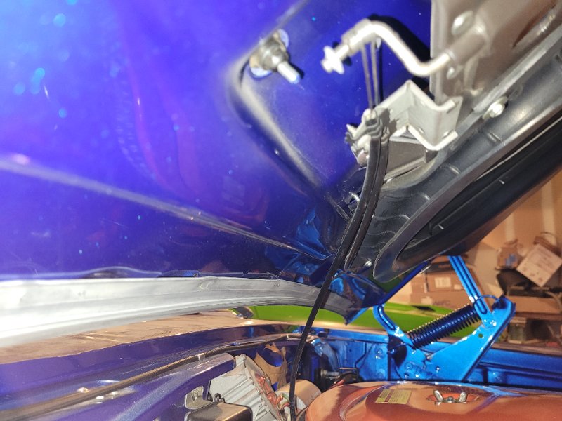

Connects to passenger side and joiner cable does as well that goes to drivers side. Give me bit.. at least the Bee is in the house garage.
