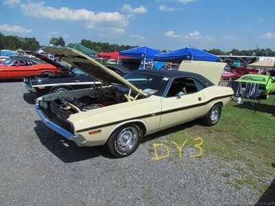

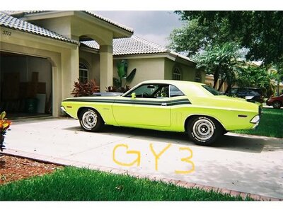

Be careful of the paint store people, they are the authority behind the counter and mix paint, but they don’t know our mopars.
The paint store person tells me that the first digit on the paint code doesn’t mean anything. 1969 and newer had the 3 digit code on the tag and broadcast sheet.
So take DY3 cream and GY3 curious yellow. The First digit is the year it came out. So D=1968. And G=1971. So if she ignores the first digit what color will she mix? The paint store person would have you believe these are the same color because the first digit doesn’t mean anything. I had her look both these mixEs up for the years and see the color difference, she was perplexed and just dropped the subject and moved on.
Another great example is B5 blue. It first was a standard color in 1969. So no your 1968 or 1967 blue mopar didn’t come factory with B5 blue on it.
Well this B5 blue color has 2 codes EB5 for 1969 and GB5 for 1971. They changed the color, it’s not the same code.
