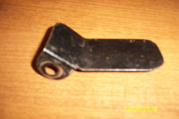

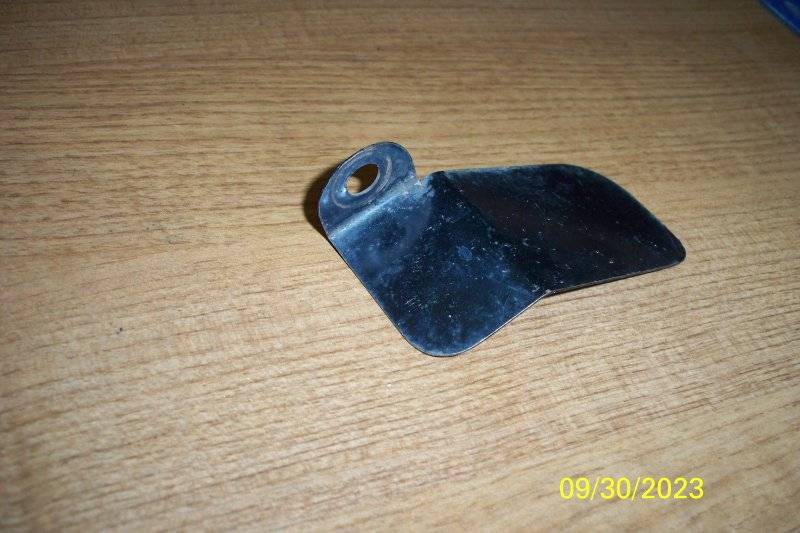

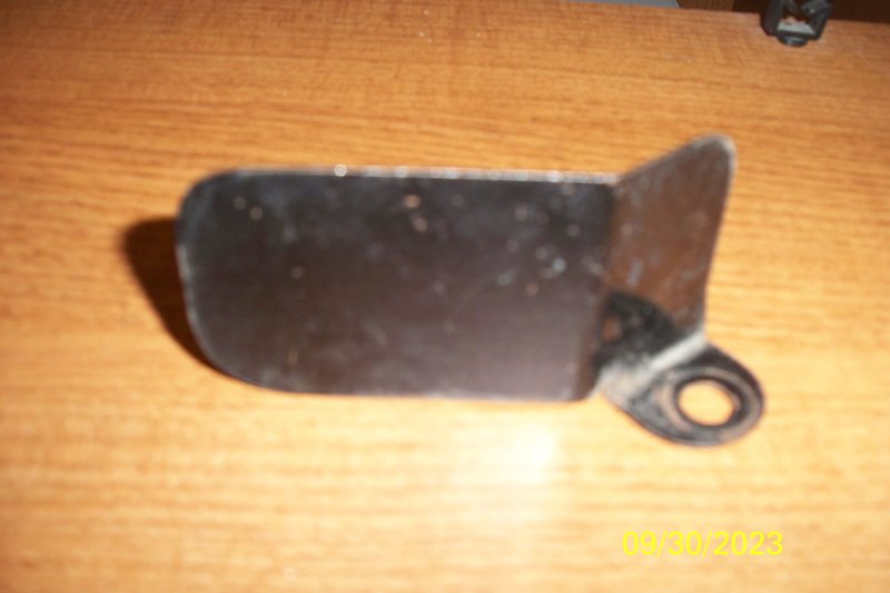

I have been given what appears to be a shield of some kind, and was told it was an oil pressure sender shield from a Hemi. If this is true it may be of some value. Can you confirm or deny? You won't hurt my feelings. Thanks for the help. 100_3082.JPG100_3083.JPG100_3084.JPG
spark plug ... next to the down pipe. truck maby???
Uses one of the rear choke tubes bolts and mounts above the oil pressure sender on street hemi

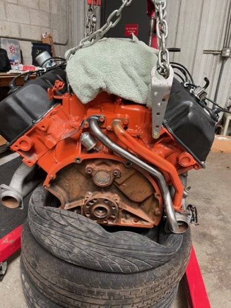

Pressure sender heat shield. Think it's on wrong, should be between the sender and the heat tube?
