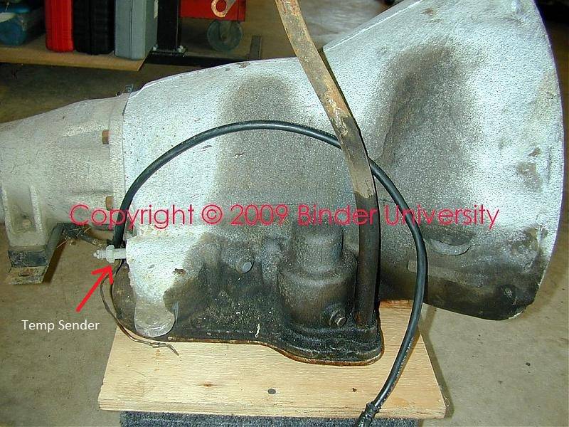

I didn't realize it was bold. He'll i don't even know how I did that, lol. When the street car got a temp gauge I didn't have access to a welder. So in the line it went. Gone to putting them in the pan since. Especially racecars. For sure detting at the line against the converte is going to drive up.the temperature. I'm more interested in the temp of the fluid reserve in the pan. No argument was being made.
