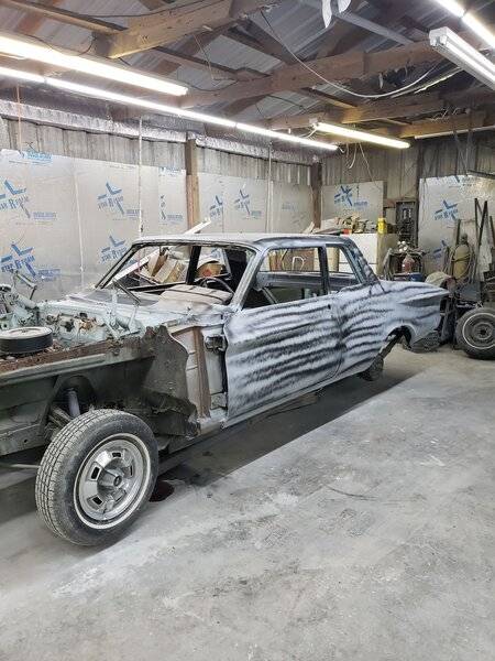

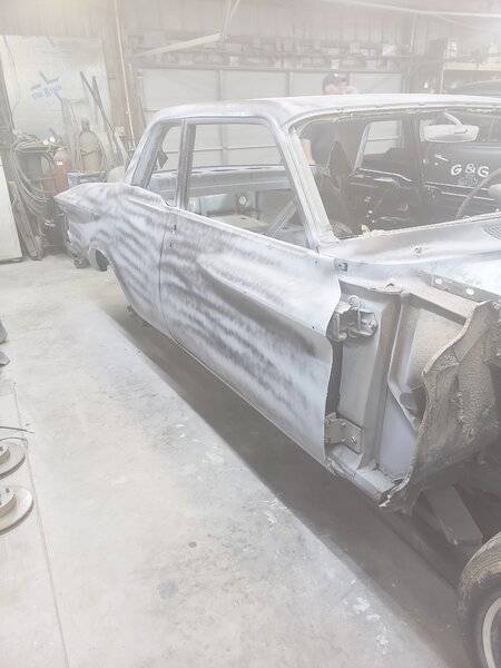

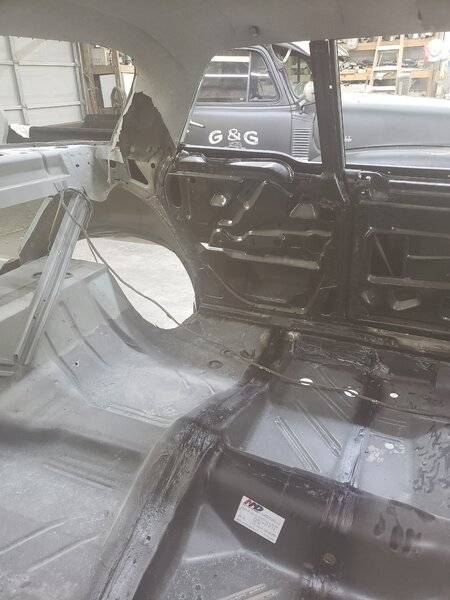

Here is my work in progress before the tubs went in. Could not find the Savoy post assembly so used a '62 dart and the skins from the rear doors of the 4 door Savoy. Came out really nice.
