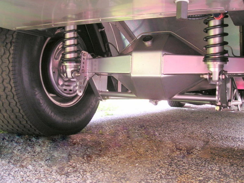

Unless it's for a "pro-show" type car, the only thing on it worth using is the housing. I'd move it on down the road and that would cover a big chunk of the cost of just ordering an aftermarket Moser 60 or something along that lines. I contemplated the same thing and decided to build a fab9 rear for mine.
