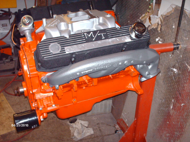

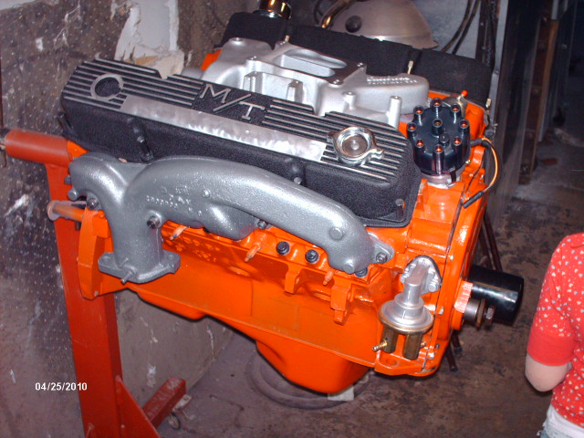

My Dodge 440 has a 440 installed in it. It has M/T valve covers with no provisions for a pvc valve.
I guess I could drill one in and get the grommet, or just get a grommet to take up one of the oil filler breather caps.
I've seen pictures of engines on the forums that appear not to have any, 1 side, or both sides.
What's the story? Need any more information on the motor let me know.
