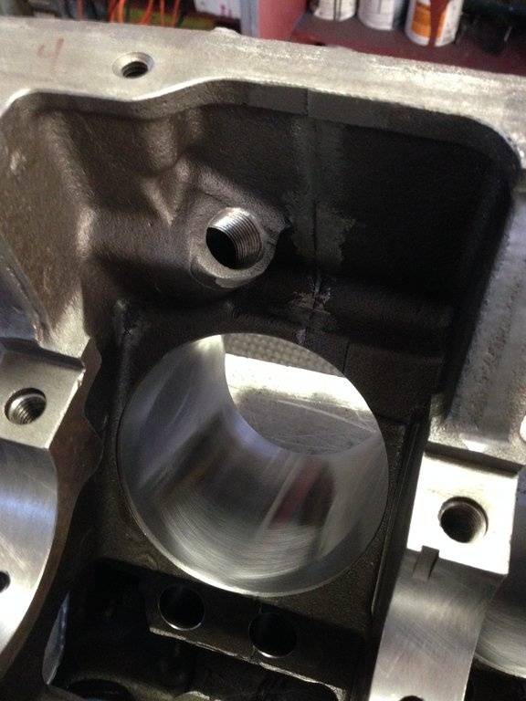

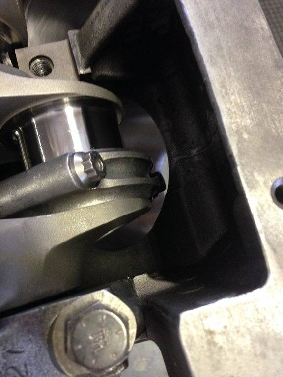

How many cylinders did the 512 require to be notched? That's why I went 470, may not have to notch anything including the oil pick up boss.
Source claims their 512/400 crank drops in with no clearancing. Oil pump pickup boss still seems questionable. The extra 4.25" stroke make the 2500 RPM power issue even easier. The big torque down low makes up for HP. Correct cam & intake combination is still critical.
None on the last one I built. Only needed 2 minutes worth of grinding on the oil pump boss. Other than that it fell together.
Has more room here than what it looks like in the picture
That's very cool! I thought that all the cylinders would need to be touched with a 4.25 stroke.
