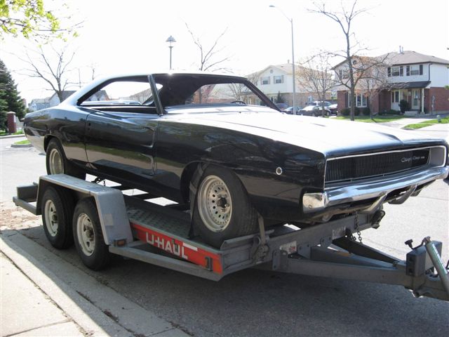

My father in law has given me an old 727 that has been sitting in a Barn for a LONG time. Before I get it rebuilt I just want to make sure it will work for my application.
It will be going into a 68 Charger with a stock 383 and stock rear end.
Is there a set of numbers I should be looking for on the tranny?
Is there a year I should avoid? How do you tell what year it is?
I have heard there are different tail stock lenghts? what do I need?
Also if it will work is there any thing I should be asking to get done while it is getting rebuilt?
Any help would be appreciated. :iamwithstupid:
No cars that I know of came with the short tail shaft 727....but they did show up in some pickups and all motor homes that came with a big block. The transmission for a 68 B body car should be about 34 1/2" long.....stem to stern.
