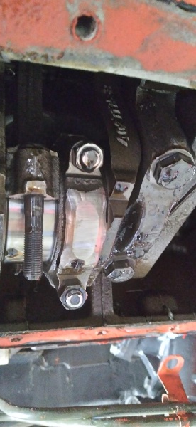

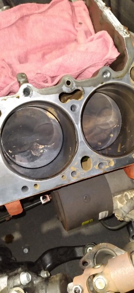

Thanks guys yes it’s still a push button shift, and it’s running a cut flex plate and the 11 inch converter has no weight. The front damper is the late external. As far as the crank balance goes it’s running the Speed Pro L2355L-030 pistons and looks like a lot of grinding. All the bearings looked good and checked in spec. Don’t know the bolt mfg but it looks aftermarket but without dimples to check stretch
