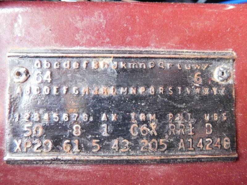

Need a little decode help
44070dart
9:32 AM
Jul 7, 2009
1,948
2,207
right behind you
68 Charger.. I've got (I think)
383 2bbl
auto trans
7.75x14
Feb. 5th
2:76
Blk int. Burgundy metallic
Wheel molding
anything else...thanks
383 2bbl
auto trans
7.75x14
Feb. 5th
2:76
Wheel molding
a6 console
b4 bucket seats
w6 built for Canada
25 drip rail moldings
30 body belt moldings
78 wheel lip moldings
A1 2:76 rear ratio
