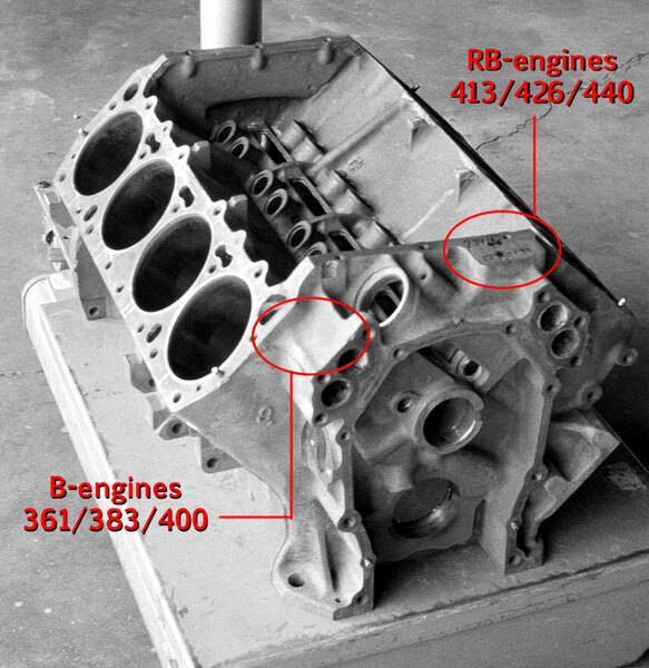

On the 383 in my ‘69 the year info is stamped in large raised letters on the side of the engine block. Drivers side I believe. Says “9 21 68”. Also there is a VIN stamp on the passenger side of the block just above the oil pan IIRC. Has the last 8 digits of the VIN. Mine says 9A152***. The 9 being the year(1969) and the A being the plant it came out of.
Found this in an old thread here in reference to locating info from topside of engine. I’ve never looked for this on mine.
The folks around here may have other ways to decipher engine year as well. We’ll see what they say.

Awesome thanks! I was able to find numbers stamped on the passenger side of the engine under the distributor. Has the size, 383 and the date right below it. Thank you again!!!
