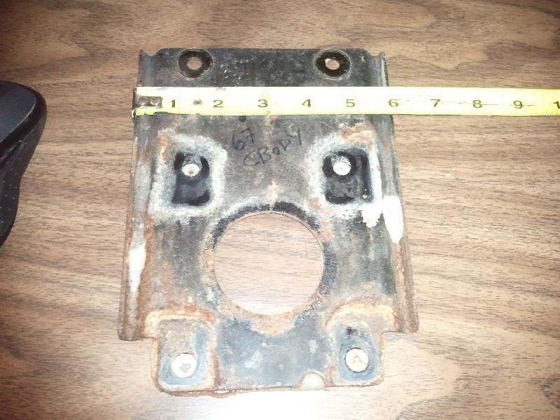

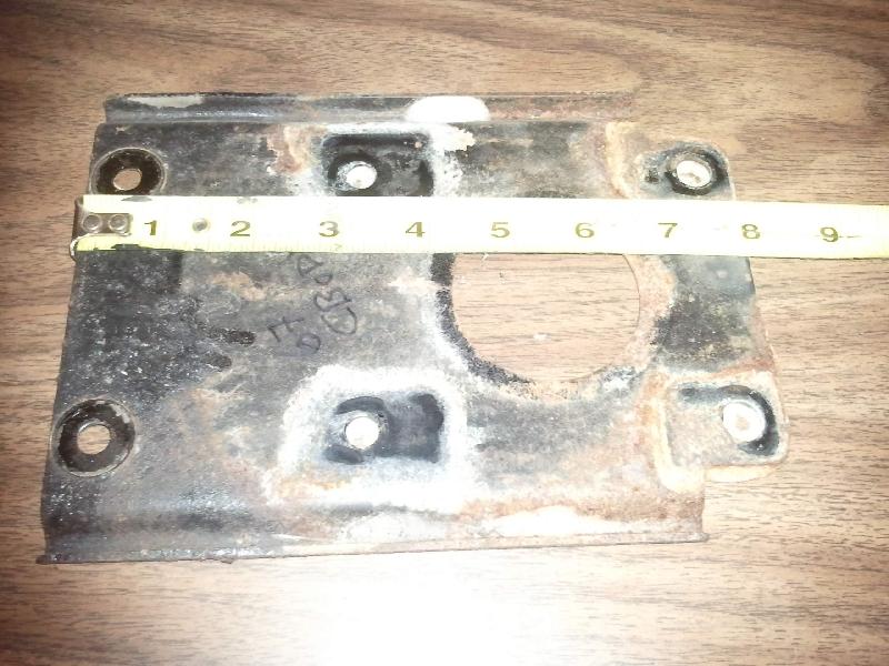

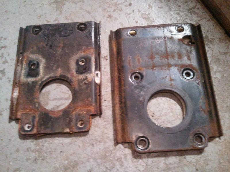

I dont know if either of these would work for you but I have a 67 and a 73 but they are from CBodys
Let me know if either will work for ya
Those are different, but may work. The charger one is also way different and won't work.
You need to find one from 62-65, also a manual plate will work but you will need to enlarge the bottom hole for it to work with power brakes.

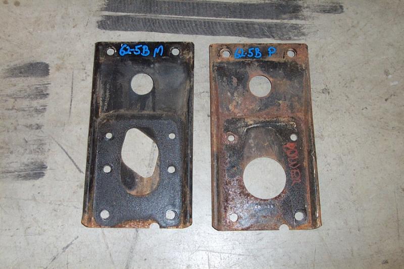

Here are the 62-5B master plates. Different than 66-70 and 71-74.
I was trying to remember who posted that pic.
