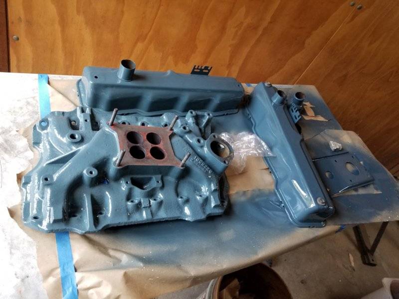

I just removed and painted my intake and valve covers because they looked terrible and were leaking. I have some questions for some seasoned mechanics on what the best methods, or any tips and tricks that can be used, to install it again.
My main concern is the intake. I've never installed a large V8 intake like this. I have a good idea of the process but its more the details I don't want to get wrong.
I got a Felpro intake gasket set for my Poly 318 which includes: two metal compression side gaskets, two small rubber/neoprene gaskets (almost foam like) for front and back engine block, and a small tube of black RTV.
Should I even use the little rubber/foam pieces OR only use black RTV to seal the front and back--- or a combination such as using a bit of the RTV to glue those gaskets in place? I've watched some videos and read that people don't use those gaskets altogether (only RTV) because they don't like to stay put during install, and also leak over time due to shrinkage and cracking... has anyone experienced this who could give me advice?
Also seen a few videos where people put a small bead of silicon around the water passages.
Would that be a good idea or is it overkill, obviously I don't want the water passes to leak. I usually stay under the assumption that gaskets should not be combined with RTV but maybe this case is different.
Thanks in advance !
You can use those gaskets as is or seal them with Gaskacinch or Ultra Grey. The intake is wet so it has coolant passages so I would apply Ultra Grey around the passages.
Throw those foam end pieces away. Use Ultra Grey on the front and back. How big of a gap is there between the intac and block? Mine was about 3/16" so I filled it with Ultra Grey.
On a serious note, I don't like silicone, it's for rain gutters. Call me old school but I prefer Permatex #2.
I'd use Copper Coat spray on the runner gaskets, a light spray on both sides of the end gaskets. Use a small bead of Permatex #2 around the water passages and in the corners where the gaskets meet. If the bolts go though into the valley, use #2 on the threads to keep oil from wicking up.
Set the manifold down squarely without moving it around. Install bolts at each corner loosely to square it up. Install the rest of the bolts loosely then snug them all down by crisscrossing. Then do your torque patteren and torque amount per your FSM.

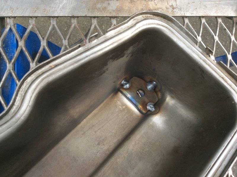

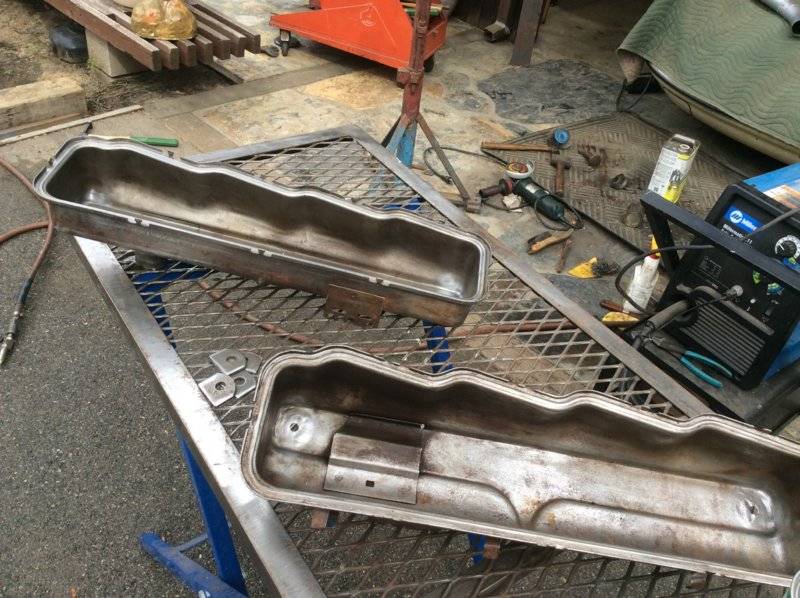

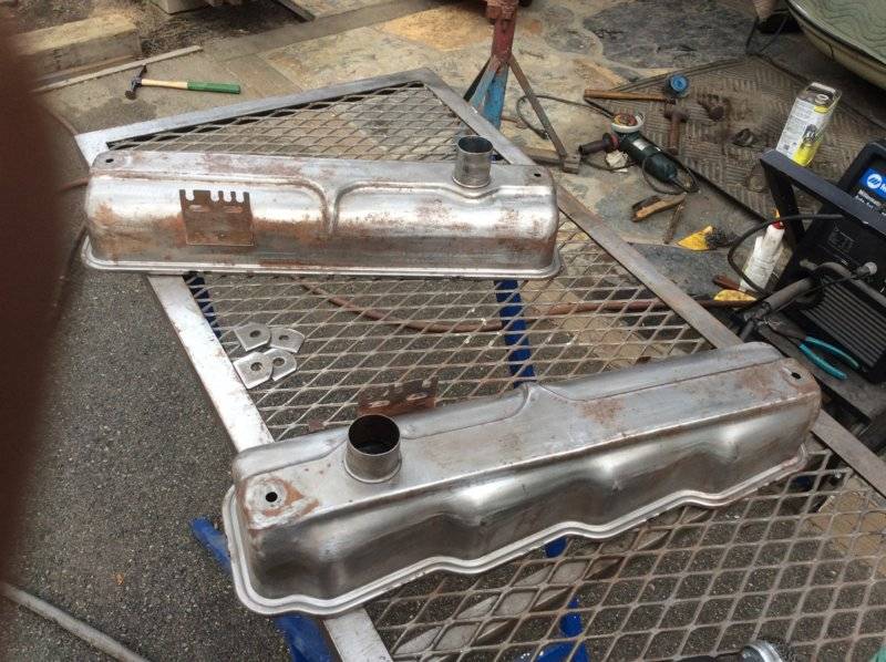

My valve covers were severly bashed up and dented inward! the sheet metal was weakened to the point where they would kind of loosen up over time--- no good!
So after I stripped the paint and cleaned, I smashed 'em back flat enough and welded in some 1/8" thick reinforcements!
