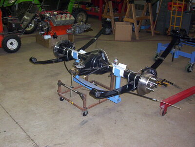

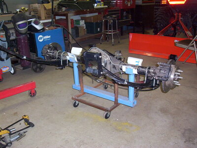

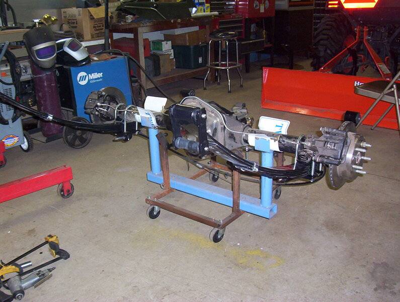

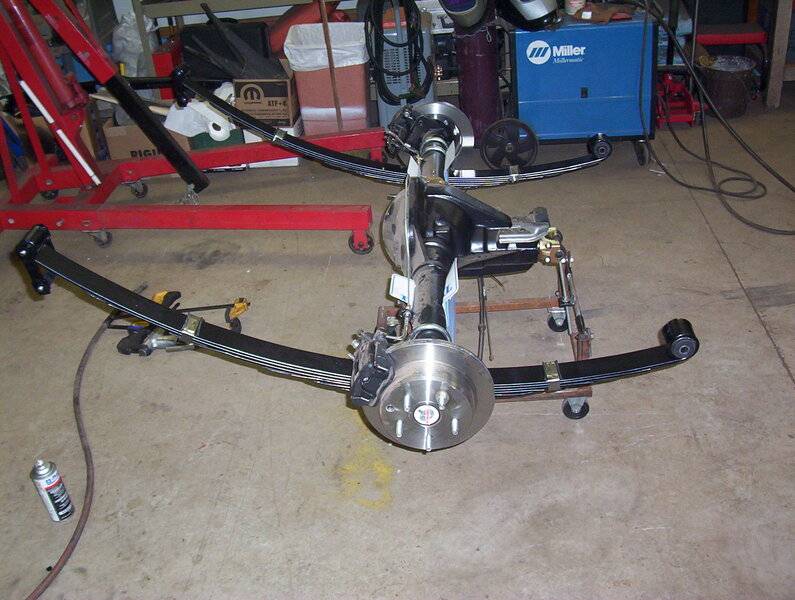

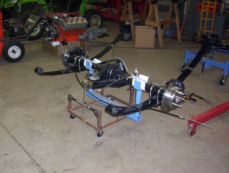

These are what Dr.Differential [Cass] sold me on my Dana 60. They were Ford Motorsports SVO calipers. Not sure who made them. The cables he supplied me with were a perfect fit on My 69 Charger.

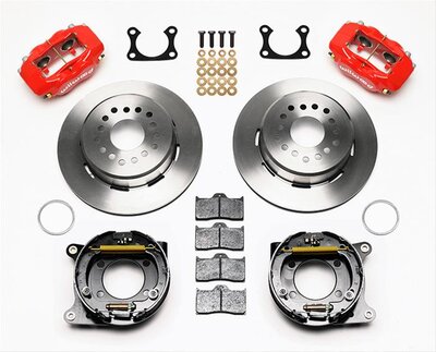

Are you saying the e brake is an additional caliper?

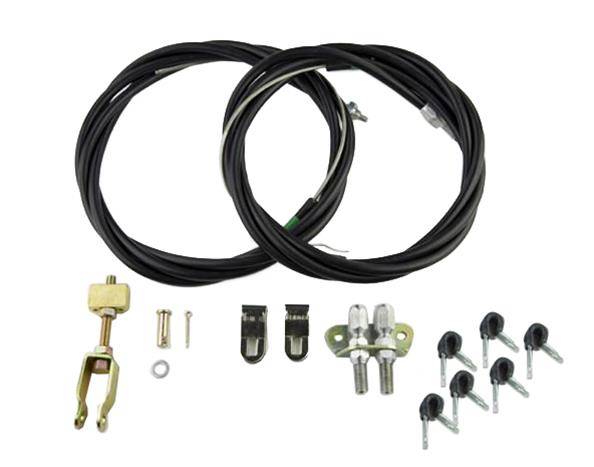

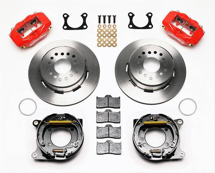

My rear disc use an internal drum on the hat. The make a dual cable equalizer kit that uses clevis and adjusters where the cables meet.

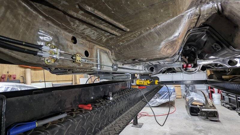

I used the Willwood rear kit pictured above. If you have frame rail connectors you can use a longer front cable and move it inboard instead of passing the bare cable though them in the stock location. I used a cable from an 80s Dodge van (raybestos c93025). Cleans it up alot, just have to shorten the inside cable slightly and re-swage or just use a new cable end like I did.
I believe Ford Explorer brake cables come in at a workable length.
